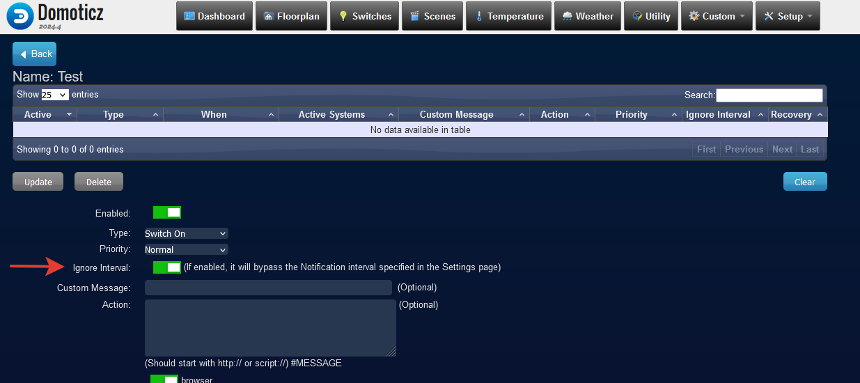

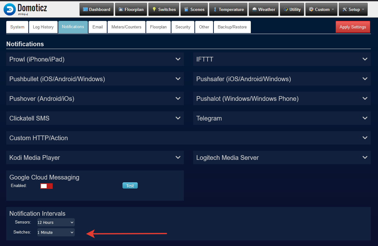

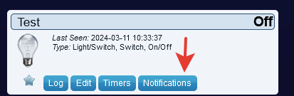

And where did you place the path to your script?
Try to put it on "Notifications"
To the "Action" field and there is Ignore interval slider
Which can be set it Setup/Settings/Notifications

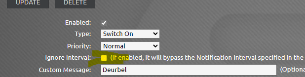

@haba
Tears of joy and happiness here, it looks like it's working!
Not sure about you example, but i had to uncheck the 'Ignore Interval' option:
