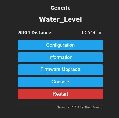

I've just setup a D1 mini (4M) with an SR04 attached running Tasmota. This is functioning as expected.
It sends data via MQTT and the MQTT server (mosquito) reports the distance correctly.
However Dom reports the distance incorrectly. It seems as though it moves the decimal point.
16cm is reported as 1.6cm
I've used MQTT as I couldn't work out how to setup a dummy device properly.

https://github.com/joba-1/TasmoticzDo you have a link to the description/instruction of Tasmoticz
Autodiscovery of Tasmota Devices for Domoticz?
What I am confused about is that the MQTT server (mosquito) is receiving the correct value from the Tasmota client, and somehow Domoticz is reading/interpreting it wrong.
Now I'm not sure if the mqtt server is providing the data to Dom properly or if Dom is reading it wrong, and I don't know how to test/check that.
It may be worth my while setting up a dummy device therefore eliminating the need for mqtt, but I don't know how to do that.
It should be noted that I do have numerous other temp/hum/switch/relay devices connected to Dom via mqtt and they all work as expected.
