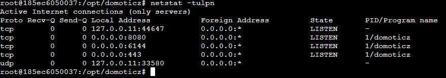

I ran netstat -tulpn inside the container and I got this response.
Perhaps you could check if it is somewhat the same.
