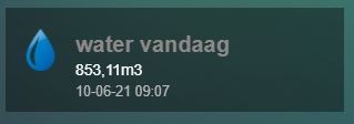

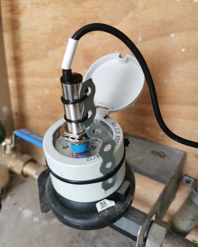

i have been able to read my watermeter from vitens en get the liters in Domoticz and Dashticz.
The only problem i have is that the block is displaying the "total meter reading" instead of only the total day usage?
if i click on the block i can see the total day usage in the left upper corner (0,05m3), but i want tot show this directly on my dashboard.
and if its possible in liters...
Does anyone know how to do this?
blocks[water_vandaag] = {}
//blocks[water_vandaag]['filter'] = 'day';
blocks[water_vandaag]['width'] = 6;
blocks[water_vandaag]['image'] = 'water.png';
blocks[water_vandaag]['title'] = 'water vandaag';
blocks[water_vandaag]['show_lastupdate'] = false;
blocks[water_vandaag]['protected'] = true;
blocks[water_vandaag]['popup'] = 'graph_92';
// Definition 'water' graph
blocks['graph_92'] = {
  devices: [92],
  title: 'water',
  graph: 'bar',
  datasetColors: ['yellow'],
    legend: {
      'v_92': 'waterverbruik'

Hi Nils, did you find the solution to show only the day usage?
I now have the same setup- and have the same problem...
I only see the total used liters/m3 and not the daily usage in dashticz
NilsNijenhuis wrote: Thursday 10 June 2021 9:29 Hello,
  devices: [92],
  title: 'water',
  graph: 'bar',
    legend: {

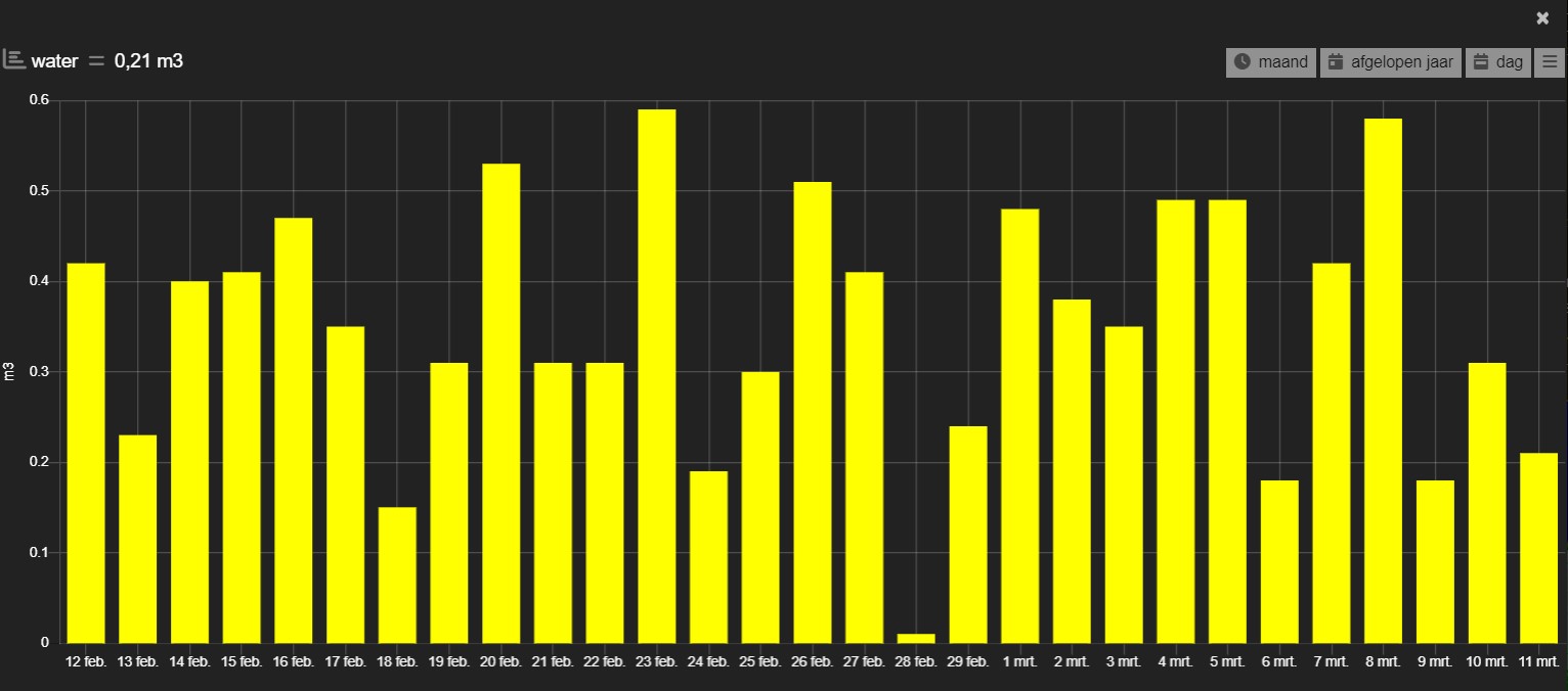

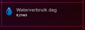

I used counter and not the incremental counter and it worked!

yes i have a day usage in the block of the water meter
// water meter = water_vandaag
blocks[water_vandaag]['value'] = "<CounterToday>",
blocks[water_vandaag]['title'] = 'Waterverbruik dag';
blocks[water_vandaag]['last_update'] = false;
  devices: [92],
  title: 'water',
	custom : {
        "maand": {
            range: 'year',
			graph: 'bar',
            filter: '1 months',
            data: {
                m3: 'd.v_92',
        "afgelopen jaar": {
			graph: 'bar',
			range: 'year',
			groupBy: 'month',
			aggregate: 'sum',
            data: {
                m3: 'd.v_92',
  	    "dag": {
			graph: 'bar',
            range: 'day',
			//filter: 'today',
            groupBy: 'hour',
			data: {
                m3: 'd.v_92',
