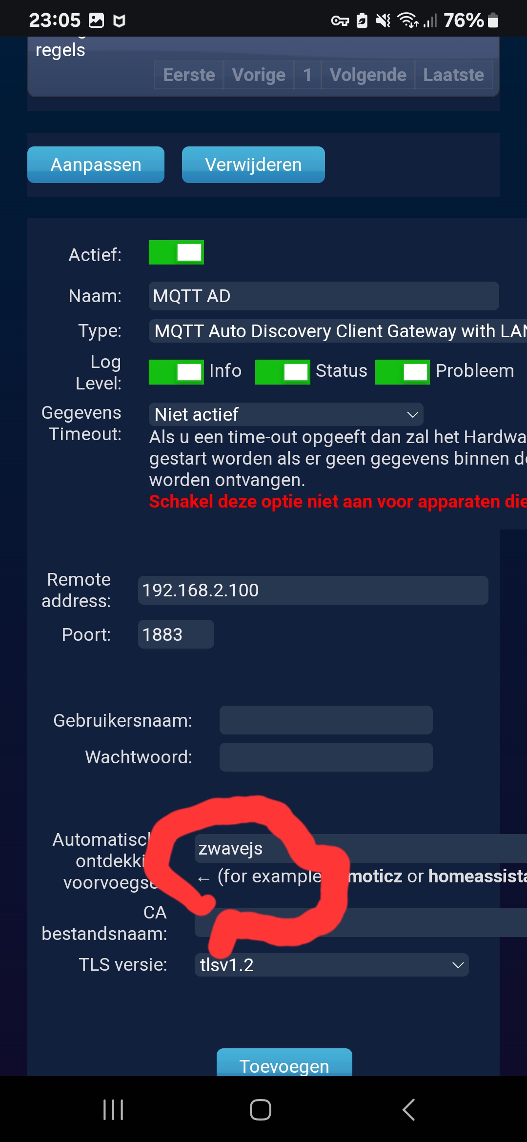

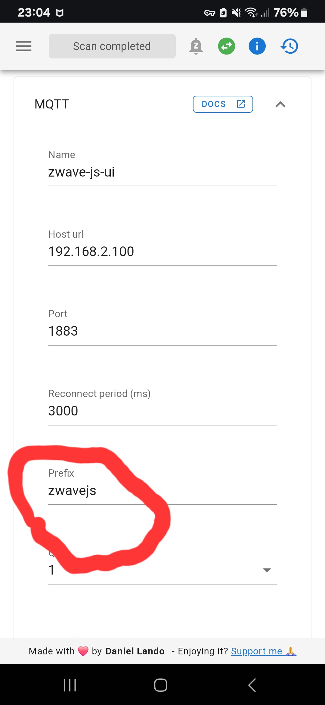

Re: Z-Wave not working under Zwave-JS-UI
prefix to be changed both in zwavejs as well as domoticz hardwarepage
- Screenshot_20240310_230534_Chrome.jpg (333.73 KiB) Viewed 3133 times
- Screenshot_20240310_230451_Chrome.jpg (197.17 KiB) Viewed 3133 times

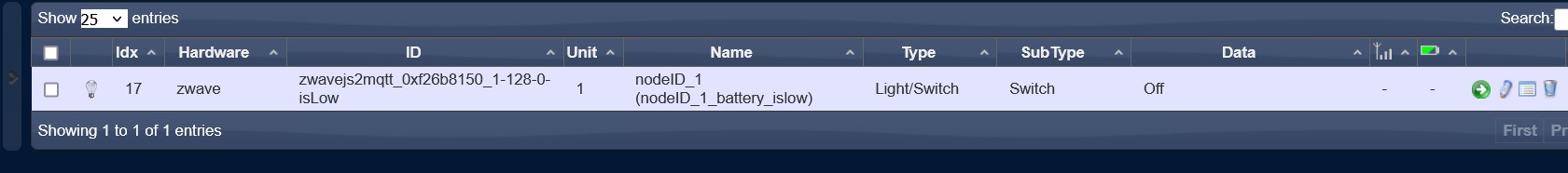

Well I now get this
- switch.jpg (53.14 KiB) Viewed 3102 times
BartSr
- Posts: 540
- Joined: Sunday 03 July 2016 16:16
- Domoticz version: V2024.7
imho zwave2mqtt is now running as expected. And what is on zwavejs-ui control panel?

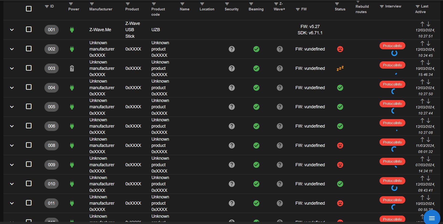

I have this
- control panel.jpg (268.01 KiB) Viewed 3089 times
- jvdz
- Posts: 2476
- Domoticz version: 4.107
Looks like your nodes aren't discovered yet, so you first need to get ZWAVEJS2MQTT working properly, before you can do anything with domoticz.
