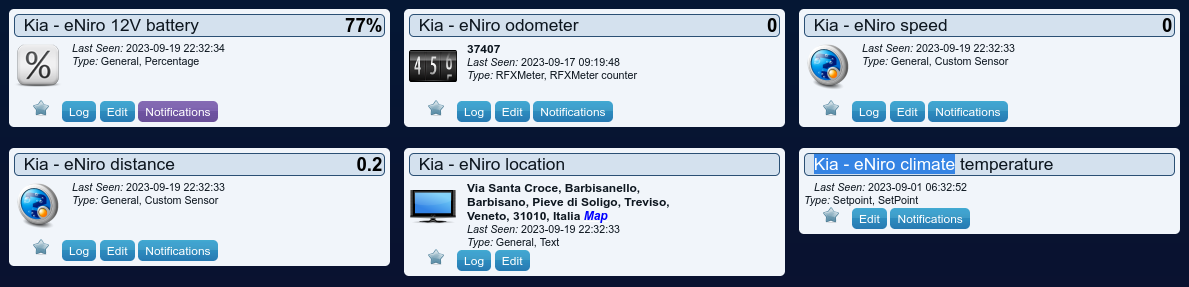

How can I test it? I've updated to the latest beta, and if I go on Dummy hardware and create a virtual device, I still see the thermostat setpoint (not generic setpoint) without any ability to set min, max, inc values and unity of measure from the UI.
Also, the old installed thermostat have stopped working properly (icon has been removed and I cannot see current temperature and can't update it).
Check the highlighted device in the picture.... Thanks a lot!
