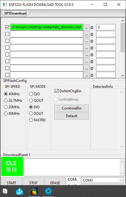

Maybe I'm just uploading this file to my display incorrectly. I do it with flash_download_tool_3.9.5
In the same way, I upload the bin file from Openhasp and it works. The only thing is that I load the Full.bin file into Openhasp and @Thorgal789 probably sends me OTA files from Platformio. That's why I wanted him to send me the Full.bin file

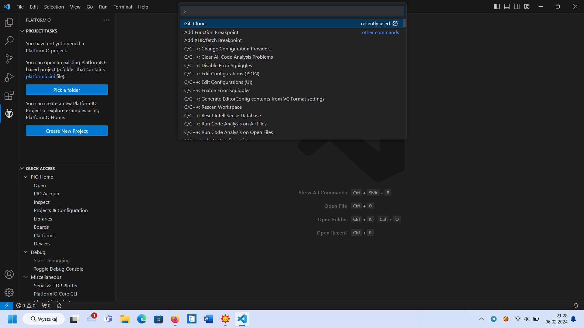

As far as I know, in order to obtain two files full.bin and ota.bin in Platformio, the project must be loaded via Git

On your capture you are using DIO, and they are saying here to use QIO https://wiki.makerfabs.com/ESP32_S3_Par ... Touch.html
There is so much contradictory information for this device ...
On my platformio I haven't configured anything for OTA, when I start a compilation, I have only 1 file every time. Can you share your platformio logs when launching the compilation ? (But on separate site, like pastebin pls ?)

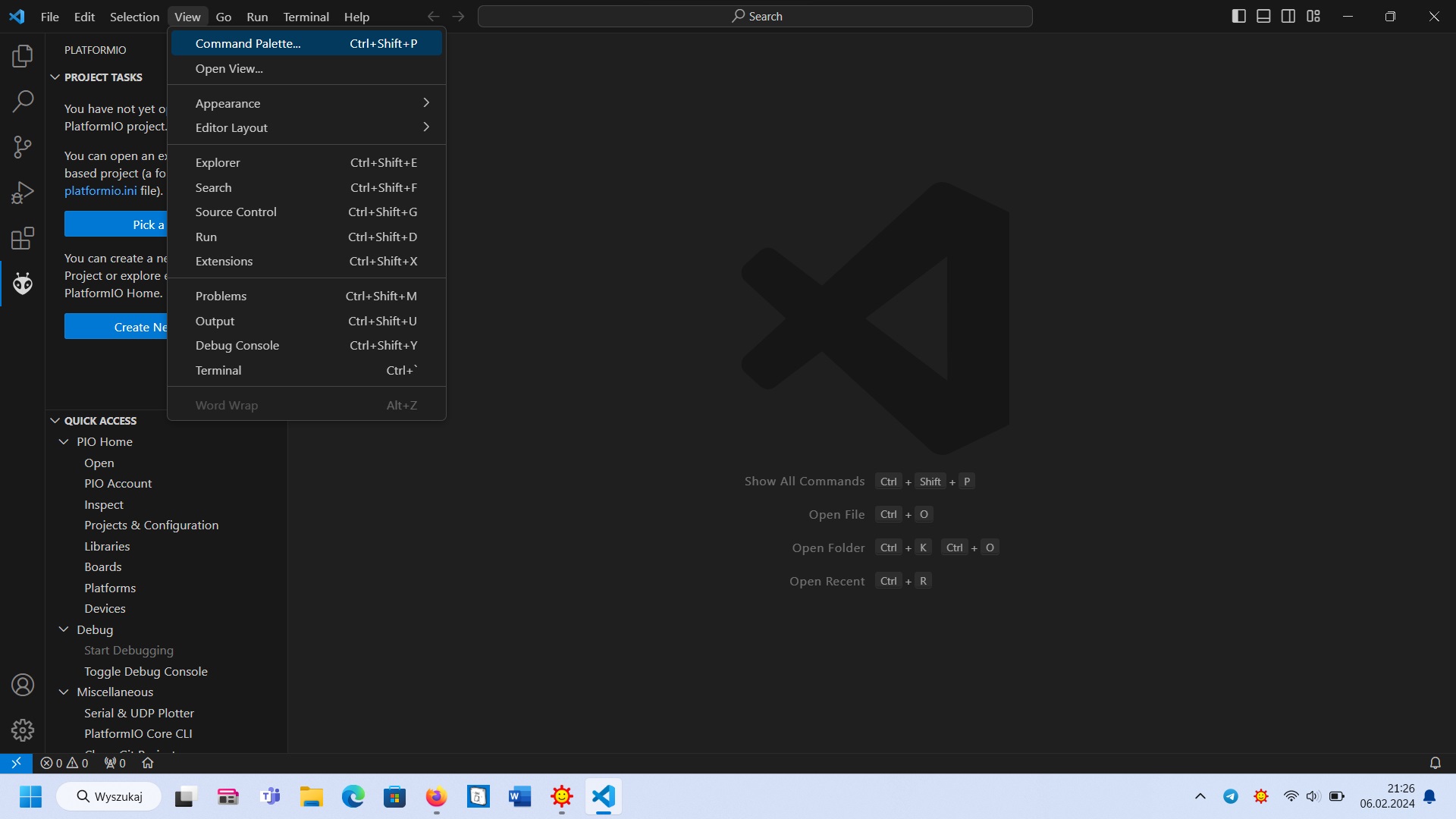

I uploaded it with the QIO setting. Same. Black screen. If you do as I wrote in the last post on the forum (pictures), you will receive two files from Platformio. (full and ota)
But I'm telling you again that you need to change line 14 in the esp32-E32S3RGB43.json file from the boards directory "-DTFT_BACKLIGHT_ON=HIGH" to "-DTFT_BACKLIGHT_ON=LOW",
otherwise my display with a soldered resistor will not work. The screen will be turned off.

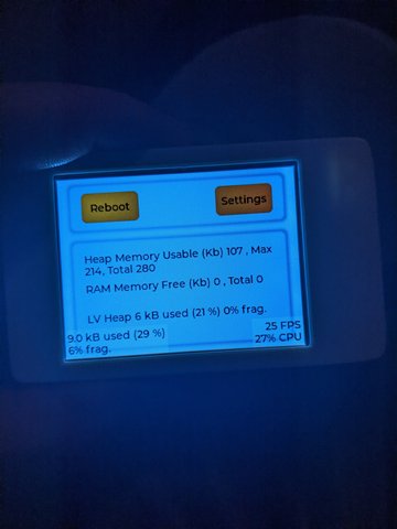

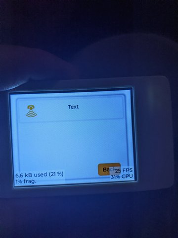

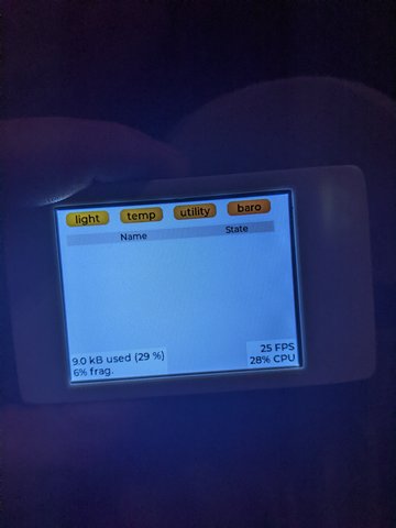

@kniazio, on your first capture, go in "setting".
- Check or uncheck "Invert colors"
- On bottom "Dft devices", set the devices you want to be displayed in home page, else it will be 1,2,3,4,5,6,7,8,9.
If you want to be faster on the code, on file platoformio.ini enable the line 33
-DFORCE_CONFIG
and you can set all your setings in main.cpp file. Wifi, domoticz and IDX to display, easier than using the touchpad to set them.
const static int t[] = {37, 81, 16, 36, 28, 35, 57, 3, 45};
On your last capture, press "light", you will see all your "lights" devices.
"Water foutain" ? was not an Humidity sensor ?
@gropi, no, those devices are not powerfull enought to use a complete web browser.

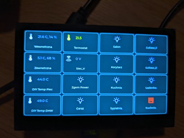

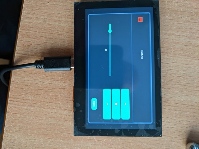

Work on the Makerfabs display is in full swing. Working with @Thorgal789 is a pleasure. He reacts and responds to my requests and inquiries immediately. Every comment I make is accepted and resolved as far as possible. @Thorgal789 approaches it very professionally.
Here are samples of my display made by @Thorgal789.
kniazio
Posts: 202
Joined: Thursday 06 October 2016 8:14
Domoticz version: 3.7243
Re: New project, a small wall display to control Domoticz using CYD (Cheap ESP32 touchscreen)
Post by kniazio »
homescreen
