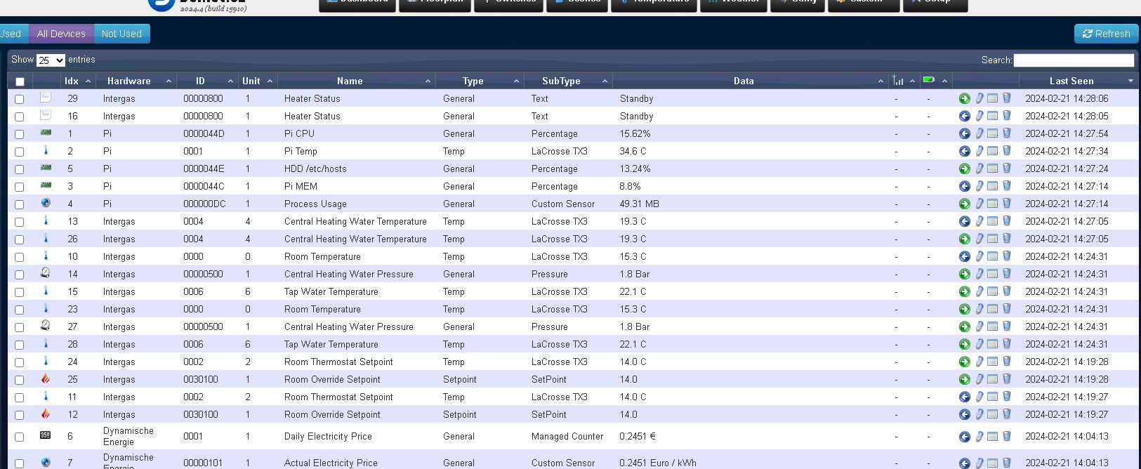

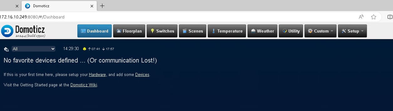

As a test i stopped Domoticz, made a duplicate and started the new duplicated Domoticz. Domoticz starts ok, but is missing all the devices from the dashboard. When i look in Setup/Hardware and Setup/Devices, all the hardware and Devices are present. I refreshed/cleared browser cache but no change. Also Switches, Temperature, Utility show no devices. Restarting Domoticz, Portainer, Pi does not change it.
So i stopped the duplicate Domoticz and started the original Domoticz. Also the original Domoticz is not showing the Devices on the Dashboard, but they are Present in Setup/Hardware and Setup/Devices.

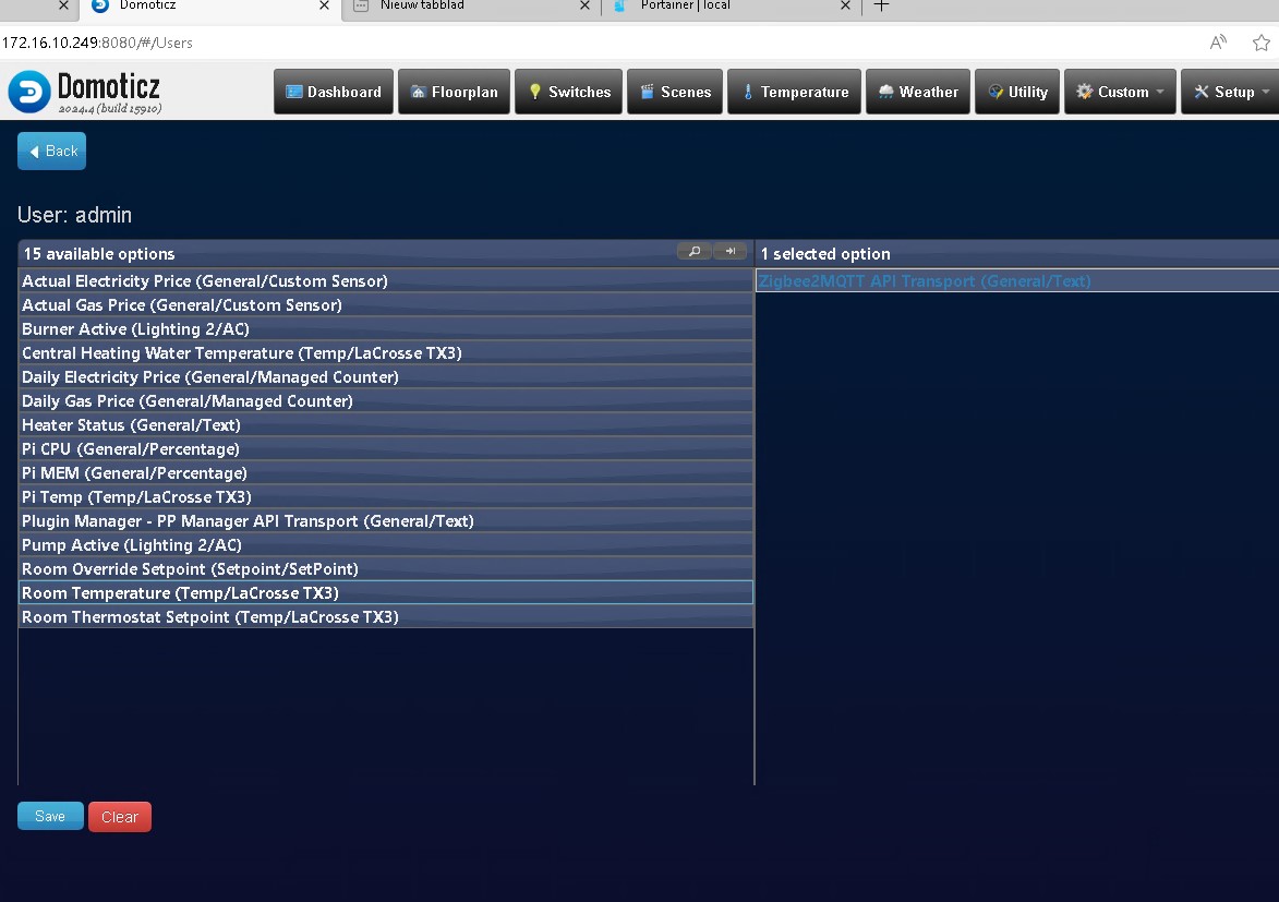

Could be a caching issue (not likely) what happens of you open the duplicate in an incognito/private browser session?
Else check device assignment in menu Setup - Users. For an admin role the assigned devices list (right column) should be empty.

Then i checked Setup/Users and saw ZigbeeMQTT API .... on the right side. It was on the Left side before the duplicate (!)
changed it back, Save and presto, there are all the devices back again. Strange thing that i dont have Zigbee device connected yet All the devices are "local" devices ....

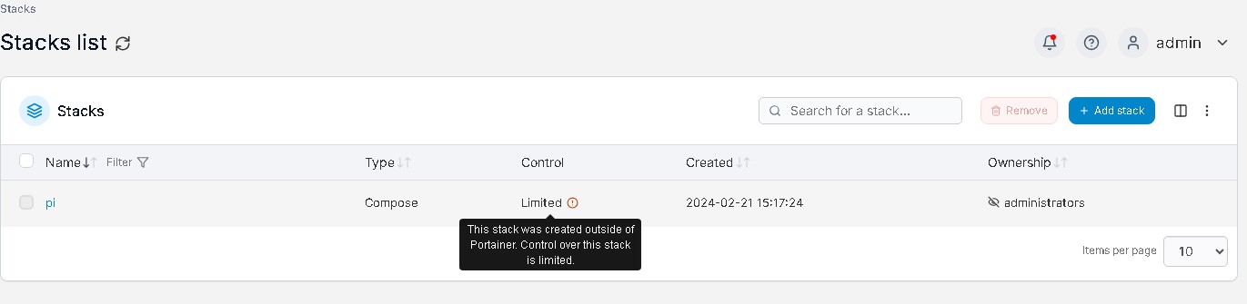

Only now i see a "limited" mesage in portainer. "Stack was created outside of Portainer" (there is no official description for installing Domoticz container inside Portainer)

Portainer only manages the docker containers and gives you the ability to do just that over a web interface. If the container starts defective it is caused by the docker settings or a malformed docker-compose yaml.
Portainer has nothing to do with this problem.

When you create the container outside of portainer, with docker composer for example, you will see that message as the stack wasn't created via the Portainer webinterface.
In case you want to use portainer to create the Domoticz container, you can copy the content of the compose file and create it in portainer.
Agree there is no relation to the portainer message and any issue you see in the running docker container as docker is doing the actual work and Portainer simply a shell around it to maintain your docker environment.
