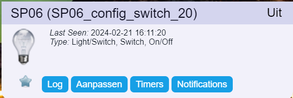

2024-02-21 16:00:04.098 Status: ZWAVE: discovered: SP06 (SP06_electric_kwh_value)/SP06 (SP06_electric_kwh_value) (unique_id: zwavejs2mqtt_0xd2e54cd5_82-50-0-value-65537)
2024-02-21 16:00:04.198 Status: ZWAVE: discovered: SP06 (SP06_electric_w_value)/SP06 (SP06_electric_w_value) (unique_id: zwavejs2mqtt_0xd2e54cd5_82-50-0-value-66049)
2024-02-21 16:00:04.198 Status: ZWAVE: discovered: SP06 (SP06_electric_v_value)/SP06 (SP06_electric_v_value) (unique_id: zwavejs2mqtt_0xd2e54cd5_82-50-0-value-66561)
2024-02-21 16:00:04.299 Status: ZWAVE: discovered: SP06 (SP06_electric_a_value)/SP06 (SP06_electric_a_value) (unique_id: zwavejs2mqtt_0xd2e54cd5_82-50-0-value-66817)
2024-02-21 16:00:04.300 Status: ZWAVE: discovered: SP06 (SP06_config_switch_20)/SP06 (SP06_config_switch_20) (unique_id: zwavejs2mqtt_0xd2e54cd5_82-112-0-20)
2024-02-21 16:00:04.401 Status: ZWAVE: discovered: SP06 (SP06_config_number_21)/SP06 (SP06_config_number_21) (unique_id: zwavejs2mqtt_0xd2e54cd5_82-112-0-21)
2024-02-21 16:00:04.401 Status: ZWAVE: discovered: SP06 (SP06_config_number_24)/SP06 (SP06_config_number_24) (unique_id: zwavejs2mqtt_0xd2e54cd5_82-112-0-24)
2024-02-21 16:00:04.501 Status: ZWAVE: discovered: SP06 (SP06_config_switch_27)/SP06 (SP06_config_switch_27) (unique_id: zwavejs2mqtt_0xd2e54cd5_82-112-0-27)
2024-02-21 16:00:04.502 Status: ZWAVE: discovered: SP06 (SP06_config_number_151)/SP06 (SP06_config_number_151) (unique_id: zwavejs2mqtt_0xd2e54cd5_82-112-0-151)
2024-02-21 16:00:04.603 Status: ZWAVE: discovered: SP06 (SP06_config_number_152)/SP06 (SP06_config_number_152) (unique_id: zwavejs2mqtt_0xd2e54cd5_82-112-0-152)
2024-02-21 16:00:04.603 Status: ZWAVE: discovered: SP06 (SP06_config_number_171)/SP06 (SP06_config_number_171) (unique_id: zwavejs2mqtt_0xd2e54cd5_82-112-0-171)
2024-02-21 16:00:04.704 Status: ZWAVE: discovered: SP06 (SP06_config_number_172)/SP06 (SP06_config_number_172) (unique_id: zwavejs2mqtt_0xd2e54cd5_82-112-0-172)
2024-02-21 16:00:04.704 Status: ZWAVE: discovered: SP06 (SP06_config_number_173)/SP06 (SP06_config_number_173) (unique_id: zwavejs2mqtt_0xd2e54cd5_82-112-0-173)
2024-02-21 16:00:04.805 Status: ZWAVE: discovered: SP06 (SP06_config_number_174)/SP06 (SP06_config_number_174) (unique_id: zwavejs2mqtt_0xd2e54cd5_82-112-0-174)
