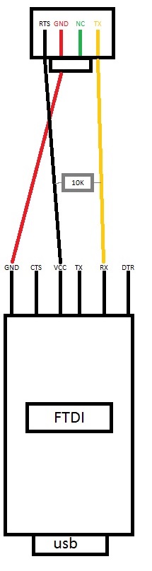

Hoi,
Ik heb een 340 chip gebruikt met een runner up weerstand. Ik krijg nu consistente rommel binnen. Elk telegram ziet er zo uit
&L&&fLM=gifLfsF:^>>>>*&F:"VR"^ZJVgifLfsF6^>>>>*>F&::VR"^ZJVgifLfsF:^>>>>>>F>>>VR"^ZJVgifLfsF6^>>>>>>F>>>VR"^ZJV&sfLLfSffsfMfff&M=gifLffsfMffS*.VR"ZJVgifLffsfMffsfffMI%M=&sfLLff3&fMff&f&M=&sfLLffS^>>>>:ZJVgifLLLy=gifLffffsfMfff&&M=gifLffffsfMffff&M=&sfLLfS&fsfMM=gifLfffsfM&ffSfM%M=gifL&FfsfMfffMiSVgifL&ffsfMffS*.VR"ZJVgifLfffsfMffsfffMI%M=&SfLffSfsfMf&&M=&SfLLfSfsfM&f&f&&&&Lf&f&&&fLf&&&f&f&f&&&&&fLM=&SfLff3fSfM&L&&&&&f&ffL%MMfffff3&&fM&M=o_2.L=hJJy>>>..2:6JVJVgif1f3fs^*>ZJV&sfLfsfsfM&L&&&&&ff&f&%M=&sfLLfSfSfMf&f&&&&&f&f&f&&&fL&&f&fL&
Er zijn wel kleine verschillen wat logisch is. Waar zit mn fout..

It's been almost 2 years since the last post here. I just want to quick ask a question.
I am going to receive Landis E360 meter in a few days and want to verify that it can actually receive the data from P1 port. I want to do it before I connect my other doungles based ESP8266 or ESP32 boards. So I want sort of verify that the port is enabled and can received the data.
Therefore I want to connect to Raspberry Pi because I think it is the simplest way to test via a wired connection.
Can you someone please share the wiring diagram using RJ12 (6pin) P1 port to the Pi and what commands shall I use to check the incoming data on the serial interface?

I have this https://www.sossolutions.nl/slimme-mete ... spberry-pi I have installed the software and that is up and running.
I do not get any data from my Landis Gyr E360.

What can be the problem?

I have now updated to the latest verson for the P1.
I now have; Seriële device in gebruik: /dev/ttyUSB1
But I still get errors.

FYI, I used an Otronic USB-to-Serial adapter with a 16pins CH340G but it did not invert the P1 signal automatically. Therefor I made a little hole in the heat-shrink and connected pin 15 (R232) with pin 16 (Vcc). Problem solved.
repnescasb
- Posts: 1
- Joined: Sunday 11 February 2024 1:16
Re: DIY cheap USB-cable to read P1 port of Dutch smart meter
I tried making this cable but got no output using either `screen` or python (with the two baud rates and 7/8 bits) for my Iskra AM550 meter.
I thought I didn't have a 10k ohm resistor so I tried with both 15k and 7.5k (two 15k in parallel). This should still be fine, right? After reconnecting the plug a couple of times the transistor died -- twice, as in it would break down and start conducting. I'm not sure what happened, only thing I can think of is reverse voltage, but I think I connected everything correctly. Anyone has an idea?
Oh, and the USB-UART chip I used is a CP2101, is that a problem?
