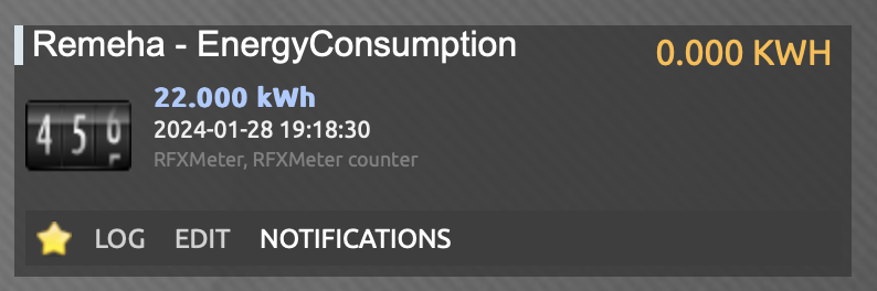

bwbboot
Posts: 26
Joined: Saturday 18 June 2016 21:05
Domoticz version: Latest
Re: Remeha eTwist
Post by bwbboot »
I am testing it. I did change the device type to Type=113 as it simply acts as a counter.
Domoticz.Device(Name=device_name_6, Unit=device_id_6, Type=113, TypeName="Kwh", Subtype=0, Used=1).Create()
Screenshot 2024-01-28 at 19.18.31.png (115.87 KiB) Viewed 77444 times
gizmocuz
Posts: 3026
Location: Top of the world
Re: Remeha eTwist
Post by gizmocuz »
Could this not be a generic kWh sensor instead of a counter?

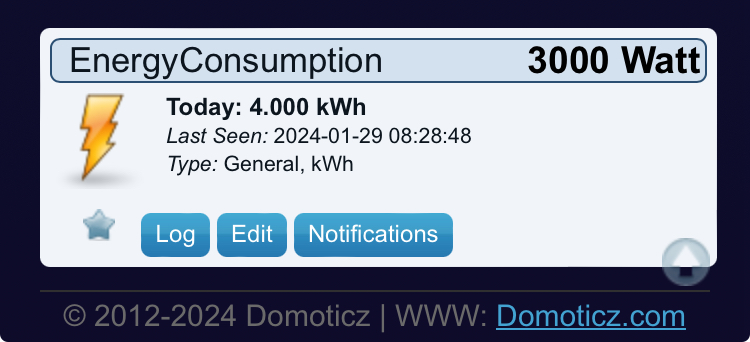

Tuk90
Posts: 50
Joined: Thursday 04 January 2024 15:44
Re: Remeha eTwist
Post by Tuk90 »
It is a generic KWH, BWBoot adjusted it for himself
Tuk90
Posts: 50
Re: Remeha eTwist
Post by Tuk90 »
Schermafbeelding 2024-01-29 om 08.29.08.png (118.19 KiB) Viewed 77408 times
gizmocuz
Posts: 3026
Re: Remeha eTwist
Post by gizmocuz »
Ahhh perfect, looking great!!

Tuk90 wrote: Monday 29 January 2024 8:28 It is a generic KWH, BWBoot adjusted it for himself
Reason I made the experimental change is, that the heat pump only provides the kWh usage, not the W from which the kWh can be calculated.
In the screenshot from Tuk90 it shows a usage of 3000 Watt which isn't the actual usage as you would see with a power meter.
I would expect it to simply display the kWh value.

bwbboot wrote: Monday 29 January 2024 9:23
I merged it to main, sometimes there are difference between the total calculation and the usage of today, but that is because of the update interval of the API.
