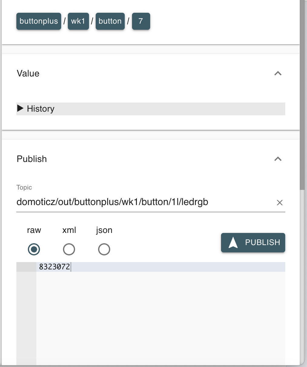

I'm using mqtt explorer. With this command 'domoticz/out/buttonplus/wk1/button/1l/ledrgb' I can switch a buttonLed with the value ' 8323072' as a raw value.
I adjust my script:
Nothing happened. I also tried:
'domoticz.executeShellCommand ( 'mosquitto_pub -h 10.0.1.122 -p 1883 -t domoticz/out/buttonplus/wk1/button/1l/ledrgb -m "8323072"' .. device.name.. '')'
Same result (my log says ' 2024-02-07 17:22:57.095 Status: dzVents: Info: template: nil'

I think I' almost there:
if I use in the sript:
domoticz.executeShellCommand ('mosquitto_pub -h 10.0.1.122 -p 1883 -t domoticz/out/buttonplus/wk1/button/1l/ledrgb/ -m "8323072"')
I get in mqtt explorer: 'domoticz/out/buttonplus/wk1/button/1l/ledrgb/ 8323072'
there are 2 spaces in between, maybe this is the problem my buttonled doesn’t switch on?
This is sent as raw data with ' -m'?
