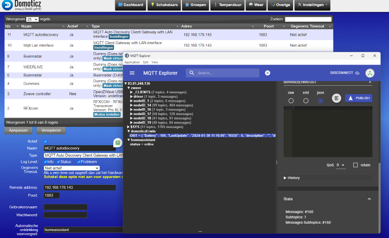

Re: Zwavejs-UI working in Control panel, but NOT in Domoticz with auto discovery
back again,
this show the hardware setup and mqtt-output. Checked the zwavejs setting against an other setup which is running on my home-location. Apart from authority key-numbers no difference i can see
- hardware and mqtt (Klein).png (167.92 KiB) Viewed 1860 times
There is something wrong in your Zwave-js-UI configuration or connection with MQTT server (from Zwave-JS-UI). The homeassistant folder in mqtt-explorer is empty. Check again the actions mentioned here https://www.domoticz.com/wiki/Zwave-JS- ... r_Domoticz
perhaps try: To add all devices at once, press "Save" in Zwave JS UI preferences. This will generate status messages for all devices
