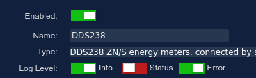

on python plugin I have the possibility to enable/disable Info, Error, Status logging.
Domoticz.Log() logs anything to the log
Domoticz.Debug() logs only if Domoticz.Debugging==1 or Domoticz.Debugging&2 , right?
Domoticz.Error() logs only if Error logging is enabled in the plugin configuration
Domoticz.Status() logs only if Status logging is enabled in the plugin configuration
WHAT ABOUT Info ?

The log level settings in your screenshot decide if the info/status/error messages are being sent to the Domoticz log file.
A Python plugin can have additional debug levels (if implemented by the plugin author) and if set the debug messages will be shown as INFO messages in domoticz log if I am not wrong.

Hi Walter,
Domoticz.Log() always write to the log file, without care of Info ON/OFF status.
Domoticz.Error() and Domoticz.Status() work perfectly, but I don't know how to manage the Info ON/OFF flag.
