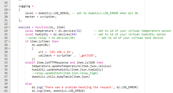

To get some insight of what you receive try this:
domoticz.utils.dumpTable(item.json)
and watch the log.

I suggest like this:
-- temperature.updateTemperature(item.json.celsius)
-- humidity.updateHumidity(item.json.humidity)
-- relay.updateText(item.json.relay_high)
Precede every line that causes trouble with comment signs like --
The script then gives you just the dump and you will be able to find how to select the dat you need.

And don't forget the domoticz.devices magic words like:
domoticz.devices('NAME_OFYOUR_DEVICE').updateTemperature(item.json.liveweer[1].temp)
or
domoticz.devices(32).updateTemperature(item.json.liveweer[1].temp)
Oh, last remark: replace my 'domoticz' with your 'dz' because that is how you tell your script to understand.
Bugs bug me.

Post by habahabahaba »
Just rename 'domoticz' to 'dz' (as you call it in "execute = function(dz, item)" at line 37 and 41 )
And then catch other errors :)

OK thanks for all suggestions I got one step further.
Domoticz is replaced with dz where needed.
Now the log spits the correct data for the script as HvdW suggested.

        if item.isTimer then
            dz.openURL(
                url = '192.168.1.19',
                callback = scriptVar .. '_getJSON',
    elseif item.isHTTPResponse and item.isJSON then
               domoticz.devices(32).updateTemperature(item.json.celsius)
            dz.utils.dumpTable(item.json)
            dz.log('There was a problem handling the request', dz.LOG_ERROR)
            dz.log(item, dz.LOG_DEBUG)

2024-01-28 15:20:00.891 Error: dzVents: Error: (3.1.8) ESP32: No status provided. Humidity not set
local scriptVar = 'ESP32'
return
    on =
        timer =
            'every minute',
        httpResponses =
            scriptVar .. '*',
    logging =
        level = domoticz.LOG_DEBUG, -- set to domoticz.LOG_ERROR when all OK
        marker = scriptVar,
        --local temperature = dz.devices(32)       -- set to id of your virtual temperature sensor
        --local humidity = dz.devices(64)          -- set to id of your virtual humidity sensor
        --local relay = dz.devices(34)             -- set to id of your virtual text device
            dz.openURL(
               dz.devices(32).updateTemperature(item.json.celsius)
               dz.devices(64).updateHumidity(item.json.humidity)
error log (see last line)

Did you read this: "You have to send status as well. See https://www.domoticz.com/wiki/DzVents:_ ... ity_sensor
And you have to calculate the status." by Kedi ?
When you are updatin humidity you have to use
updateHumidity(humidity, status)
Update humidity. status can be domoticz.HUM_NORMAL, HUM_COMFORTABLE, HUM_DRY, HUM_WET. Supports command options.
try
dz.devices(64).updateHumidity(item.json.humidity, status) or
dz.devices(64).update(item.json.humidity, status)
where status can be 0, 1, 2, 3
0 - normal
1 - comfort
2 - dry
3 - wet
Kedi
