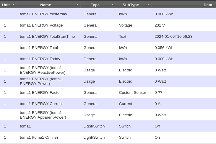

pikassent
Posts: 16
Joined: Saturday 03 December 2022 16:26
Domoticz version: 2024.4b
Location: Spain
Re: MQTT Auto Discovery with Mosquitto and Shelly1
Post by pikassent »
Hi lwolf,
It works like a charm :)
./run.sh
Mosquitto conf found.
persistence ENABLED
Ini file exists
Connecting to MQTT server...
subscribed shellies/announce
subscribed shellies_discovery/rpc
subscribed +/online
subscribed shellies/+/online
subscribed tasmota/discovery/#
Starting eval loop, waiting Shelly devices to appear on MQTT announce... press CTRL-C to cancel
on_message::payload::{"ip":"10.10.11.29","dn":"toma1","fn":["toma1",null,null,null,null,null,null,null],"hn":"toma1-1871","mac":"1234567890AB","md":"Athom SK01","ty":0,"if":0,"ofln":"Offline","onln":"Online","state":["OFF","ON","TOGGLE","HOLD"],"sw":"13.3.0","t":"toma1","ft":"%prefix%/%topic%/","tp":["cmnd","stat","tele"],"rl":[1,0,0,0,0,0,0,0,0,0,0,0,0,0,0,0,0,0,0,0,0,0,0,0,0,0,0,0,0,0,0,0],"swc":[-1,-1,-1,-1,-1,-1,-1,-1,-1,-1,-1,-1,-1,-1,-1,-1,-1,-1,-1,-1,-1,-1,-1,-1,-1,-1,-1,-1],"swn":[null,null,null,null,null,null,null,null,null,null,null,null,null,null,null,null,null,null,null,null,null,null,null,null,null,null,null,null],"btn":[0,0,0,0,0,0,0,0,0,0,0,0,0,0,0,0,0,0,0,0,0,0,0,0,0,0,0,0,0,0,0,0],"so":{"4":0,"11":0,"13":0,"17":0,"20":0,"30":0,"68":0,"73":0,"82":0,"114":0,"117":0},"lk":0,"lt_st":0,"bat":0,"dslp":0,"sho":[],"sht":[],"ver":1}
1234567890AB alive
on_message::payload::{"sn":{"Time":"2024-01-26T18:15:12","ENERGY":{"TotalStartTime":"2024-01-05T10:56:23","Total":0.056,"Yesterday":0.000,"Today":0.000,"Power":0,"ApparentPower":0,"ReactivePower":0,"Factor":0.00,"Voltage":232,"Current":0.000}},"ver":1}
1234567890AB alive
>>>Tasmota device 10.10.11.29 Athom SK01 found
domoticz.log
2024-01-26 17:15:30.527  Status: MQTTAD-Tasmota: discovered: toma1 (toma1 Online)/toma1 (toma1 Online) (unique_id: 1234567890AB_online)
2024-01-26 17:15:30.631  Status: MQTTAD-Tasmota: discovered: toma1/toma1 (unique_id: 1234567890AB_RL_1)
2024-01-26 17:15:30.734  Status: MQTTAD-Tasmota: discovered: toma1 ENERGY TotalStartTime/toma1 ENERGY TotalStartTime (unique_id: 1234567890AB-energy-totalstarttime)
2024-01-26 17:15:30.835  Status: MQTTAD-Tasmota: discovered: toma1 ENERGY Total/toma1 ENERGY Total (unique_id: 1234567890AB-energy-total)
2024-01-26 17:15:30.937  Status: MQTTAD-Tasmota: discovered: toma1 ENERGY Yesterday/toma1 ENERGY Yesterday (unique_id: 1234567890AB-energy-yesterday)
2024-01-26 17:15:31.039  Status: MQTTAD-Tasmota: discovered: toma1 ENERGY Today/toma1 ENERGY Today (unique_id: 1234567890AB-energy-today)
2024-01-26 17:15:31.141  Status: MQTTAD-Tasmota: discovered: toma1 ENERGY (toma1 ENERGY Power)/toma1 ENERGY (toma1 ENERGY Power) (unique_id: 1234567890AB-energy-power)
2024-01-26 17:15:31.243  Status: MQTTAD-Tasmota: discovered: toma1 ENERGY (toma1 ENERGY ApparentPower)/toma1 ENERGY (toma1 ENERGY ApparentPower) (unique_id: 1234567890AB-energy-apparentpower)
2024-01-26 17:15:31.345  Status: MQTTAD-Tasmota: discovered: toma1 ENERGY (toma1 ENERGY ReactivePower)/toma1 ENERGY (toma1 ENERGY ReactivePower) (unique_id: 1234567890AB-energy-reactivepower)
2024-01-26 17:15:31.447  Status: MQTTAD-Tasmota: discovered: toma1 ENERGY Factor/toma1 ENERGY Factor (unique_id: 1234567890AB-energy-factor)
2024-01-26 17:15:31.549  Status: MQTTAD-Tasmota: discovered: toma1 ENERGY Voltage/toma1 ENERGY Voltage (unique_id: 1234567890AB-energy-voltage)
2024-01-26 17:15:31.652  Status: MQTTAD-Tasmota: discovered: toma1 ENERGY Current/toma1 ENERGY Current (unique_id: 1234567890AB-energy-current)
Devices:
