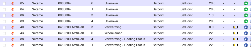

I find it strange that when using pType and sType mentioned in hardwarerypes.h
There is a LOG-statement of not correct device?
Also in Helper.cpp;
line 1096
|| ((dType == pTypeSetpoint) && (dSubType == sTypeSetpoint))
is this duplicate off;
line 1117
can the Error come from this duplicate statement?
Status: Warning: Notification NOT handled (Hardware: 2 - Netatmo, ID: 237041147, Unit: 0, Type: F2 - Setpoint, SubType: 16 - Unknown), please report on GitHub!
kind regards.

Posts: 7029
Domoticz version: 2026.3
Re: New API Netatmo
The related hardware gateway seems deleted for these devices (ID Unknown?) Then they are greyed out. Do you have more devices like that ? Perhaps they are not enabled (green arrow) but connected to your Netatmo hardware gateway?

Post by homeJLB »
With my changes to the NEW API and using Auto-discovery all the devices are like that. even with blue arrow.
But I was referring to the icon from the wind Device.

I was working on the setpoint off the thermostat.
But I got something weird.
Netamo: Setpoint ()
Status: User: domoticz initiated a SetPoint command
Error: Netamo: NetatmoThermostat : No thermostat found in online devices!
Debug: Netamo: NetatmoThermostat idx = 4
Netamo: Setpoint (Unknown)
so the action off the 4 different setpoints returns always in idx = 4 ?
and after the action there are 4 new setpoint devices??
I was thinking the idx is always unique/singular.
Is there some registration off the setpoint necessary that I don't see?
Any advice on to identify the correct thermostat setpoint ?

I have found the problem with the return of setsetpoint;
It is returning DeviceID and not idx.
sinds my id's are off "04:00:00:1a:47:3a" it was returning only 04
unsigned long ID;
std::stringstream s_strid;
s_strid << std::hex << sd[1];
s_strid >> ID;
pGateway->SetSetpoint(ID, TempValue);
where sd[1] = std::string "04:00:00:1a:47:3a"
