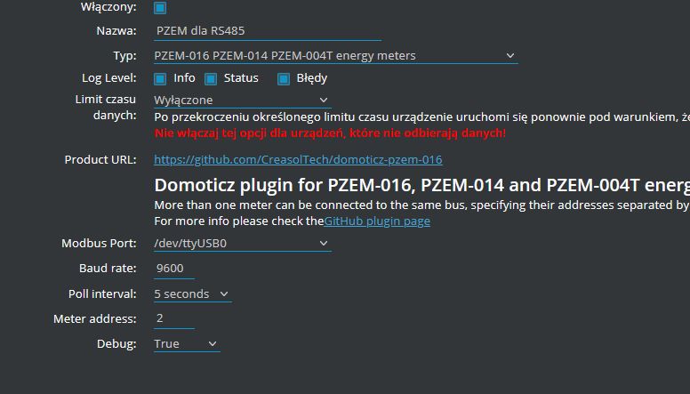

Hello
Have any of you guys managed to run PZEM 004 connected to TTL/USB and Raspberry using the plugin: https://github.com/CreasolTech/domoticz-pzem-016
And the attached diagram regarding PZEM 004?
I set the address in PZEM to ModuleAddress 2
I only set address 2 in Domoticz
Still nothing, no communication.
Where should sensors appear in domoticz? In utilitarian ? Is Configuration -> Devices ?

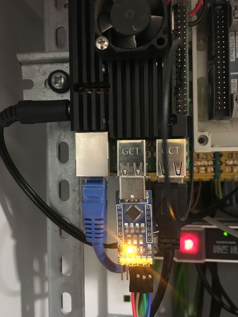

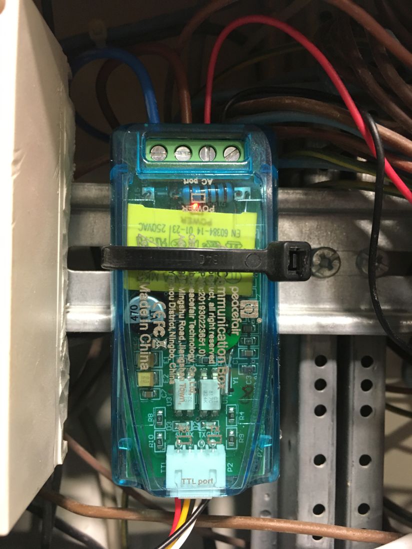

Installation photos:
