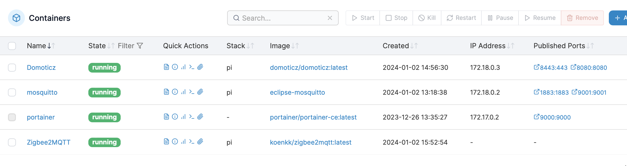

I got Zigbee2MQTT to install in docker, but according to Portainer there is something wrong in the configuration and ik keeps on re-starting.
Scherm­afbeelding 2024-01-02 om 20.00.06.png (181.1 KiB) Viewed 4120 times
Error report from Portainer:
Using '/app/data' as data directory
/app/node_modules/js-yaml/lib/loader.js:183
return new YAMLException(message, mark);
YAMLException: duplicated mapping key (6:1)
3 | mqtt:
4 | base_topic: zigbee2mqtt
5 | server: mqtt://172.18.0.2
6 | frontend:
7 | port: 9080
8 | serial:
at generateError (/app/node_modules/js-yaml/lib/loader.js:183:10)
at throwError (/app/node_modules/js-yaml/lib/loader.js:187:9)
at storeMappingPair (/app/node_modules/js-yaml/lib/loader.js:358:7)
at readBlockMapping (/app/node_modules/js-yaml/lib/loader.js:1173:9)
at composeNode (/app/node_modules/js-yaml/lib/loader.js:1441:12)
at readDocument (/app/node_modules/js-yaml/lib/loader.js:1625:3)
at loadDocuments (/app/node_modules/js-yaml/lib/loader.js:1688:5)
at Object.load (/app/node_modules/js-yaml/lib/loader.js:1714:19)
at Object.read (/app/lib/util/yaml.ts:7:29)
at read (/app/lib/util/settings.ts:333:20)
This is the docker-compose.yaml file:
version: "3.8"
services:
zigbee2mqtt:
container_name: Zigbee2MQTT
image: koenkk/zigbee2mqtt:latest
restart: always
volumes:
- /var/mydata/zigbee2mqtt/data:/app/data
- /run/udev:/run/udev:ro
ports:
# Frontend port
- 9080:9080
environment:
- TZ=Europe/Amsterdam
devices:
# - /dev/serial/by-id/usb-Silicon_Labs_Sonoff_Zigbee_3.0_USB_Dongle_Plus_0001-if00-port0:/dev/ttyACM0
- /dev/serial/by-id/usb-Silicon_Labs_slae.sh_cc2652rb_stick_-_slaesh_s_iot_stuff_00_12_4B_00_21_CC_37_E9-if00-port0:/dev/ttyUSB0
configuration file: /var/mydata/zigbee2mqtt/data/configuration.yaml
homeassistant: false
frontend: true
mqtt:
frontend:
port: 9080
serial:
port: /dev/ttyUSB0
advanced:
network_key: GENERATE
Any Help is much appreciated

And this is exactly why I use docker compose by hand and not use a frontend
a docker compose container you can start in two ways
docker compose up -d
and docker compose up
The option -d is used to launch the container in the background and keep it running.
But if there is a issue, it is best not to use the -d, so you get a log on the console and see what's wrong
Now I recently modified the ZWaveJS-UI wiki page, but the process is the same for installing zigbee2mqtt:
https://www.domoticz.com/wiki/Zwave-JS-UI
One you created the folder, the docker-compose.yml file, you can issue the docker compose up cmd and see what is wrong.
Make sure you disable the one in Portainer otherwise you might have a conflict for the port number

I think you mean that the shown error is from the running Zigbee2mqtt LOG, when you click the log in the portainer interface...right?
You really should post your yml in a codebox so we can see the spacing used as well, but I assume zigbee2mqtt is conplaing about:
port: 9080
serial:
port: /dev/ttyUSB0
advanced:

I think that the ip address of the mqtt server should be the 'local' ip (127.0.0.1) or the ip of the device it self.
Not the ip of the docker mqtt container. But I might be wrong.

Kedi wrote: Thursday 04 January 2024 17:24 I think that the ip address of the mqtt server should be the 'local' ip (127.0.0.1) or the ip of the device it self.
You should use the machine's IP address, not 127.0.0.1 or localhost (192.168.2.3)
