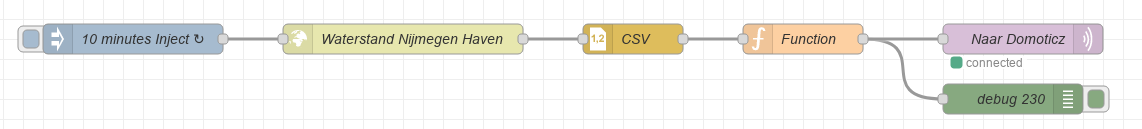

I created a new flow:
In this case, it is made for Nijmegen Haven, but it is suitable for all measuring point in The Netherlands.
As I prefer to have the configuration parameters not included in the flow, all configuration is set in the "Inject" node.
You have to insert the correct location,which you can find at: https://waterinfo.rws.nl/#/publiek/waterhoogte
To find the correct measuring point, take the following steps:
1. Click on the desired location.
2. Click on "Meer details" (More details).

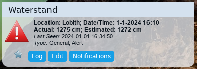

3.Check the URL (e.g. https://waterinfo.rws.nl/#/publiek/wate ... 0in___20cm, where Lobith(LOBI) is the correct name of the measuring point).
Also the Domoticz idx of the virtual "Alert" sensor should be set in the "Insert" node.
If everything is correctly configured, you will get the following for Nijmegen Haven:
or for Lobith:
You have to replace to MQTT Output node (Naar Domoticz) for your own MQTT and Config node.
As @Kedi has also created a nice and compact dZVents script. you can choose, which solution you prefer.
Please test the flow below.

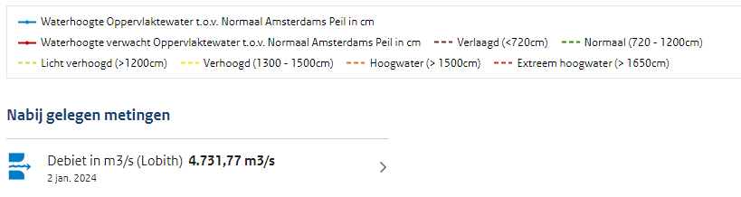

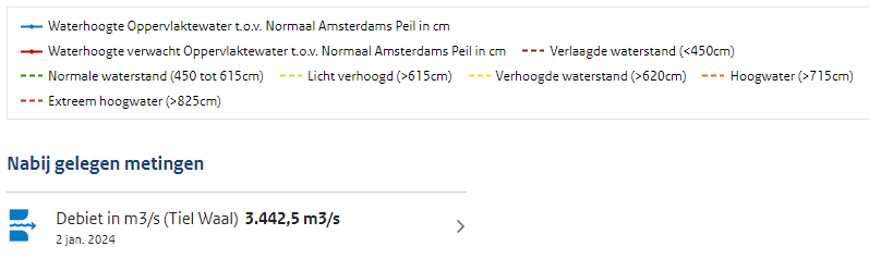

The alert levels depends on the place of the measurement, see attached pictures. So those levels should also be changed in the flow.

While checking the tables, I also found that the limits of the alert levels are different for each location. Of course, I have to say.
So the remark of @Kedi is correct. As the "API" has changed from JSON to CSV, the "index" data is no longer available.
I decided to put in fixed values, but these are only correct for "Nijmegen Haven". I will try the find a solution, because I like the way to use these in an "Alert" sensor.
I hope to find a solution for more locations and the right limit for each location, but for now the flow is only correct for "Nijmegen Haven"

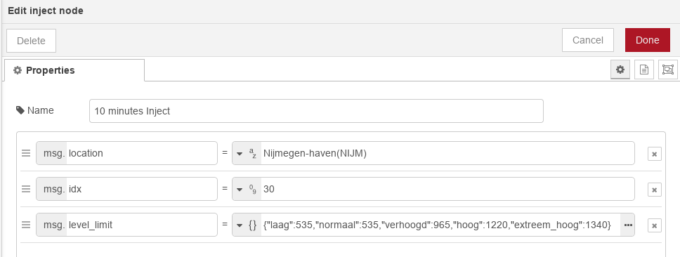

I looked once more to the flow and tried to get the limits for the water heights by means of web scraping.
It is definitely not my favorite way of collecting data. However this was not successful. So I decided to stop the attempts.
In order to configure the right levels do the following:
1. Go to https://waterinfo.rws.nl/#/publiek/waterhoogte.
2. Select your favorite measuring point.
3. Click on it and select "Meer details" (More details).
4. It will open with the graphics. See the limits below the graph or Click on "Tabel" (Table) and find the limits below the table.
5. Due to the limited levels of the "Alert" sensor, I combined the two levels of "Licht verhoogd" and "Verhoogde waterstand".

7. Insert the values in the "Inject node" in the field "msg.level_limit. See screenshot below:
Screenshot_Inject_ Water_Heights.png (22.69 KiB) Viewed 3766 times
The example is for the location "Nijmegen-haven(NIJM)
The location should be inserted in the field msg.location. The exact location name you will find in the URL after you clicked "Meer details".
The idx of the created virtual "Alert" sensor has to be inserted in the field msg.idx.
Below you will find two flows:
1. A new flow for @Jan Jansen for the location Nijmegen-haven(NIJM)
        "id": "47db295ed5bd870e",
        "type": "http request",
        "z": "f1324d44.f6688",
        "name": "Waterstand Nijmegen Haven",
