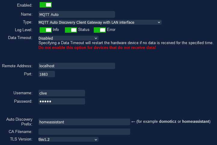

But seeing your log in the first topic you have given your hardware gateway the name MQTT Auto that lead me thinking you use the Domoticz MQTT Auto discover hardware gateway instead f the plugin.
If you used the plugin you probably would have named it Zigbee2MQTT.
Can you post a screenshot of your MQTT Auto gateway configuration page. What is written in field Type?

waltervl wrote: Tuesday 12 December 2023 23:36 Ok, you should have mentioned that before that you are using the plugin...
Oops, sorry. I used to use the plugin, looks like I'm now on auto discovery.
