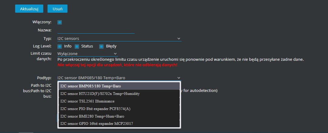

Is it possible to connect the BH1750 lighting intensity sensor directly via Raspberry GPIO to Domoticz and read the value?
Currently I have it through the weather station but I would like to build a raspberry backup with lux reading in the event of a power failure. Now I would also have to maintain the main router and the Wi-Fi access point from which the station receives the Wi-Fi signal to connect to the network and Domoticz.
I checked in Domoticz from settings -> hardware and the BH1750 sensor is missing in I2C

If not yet supported with Domoticz integration you could read the sensor with a bash or python script and have that script push the data to a dummy sensor in Domoticz.
Check out this wiki page for examples https://www.domoticz.com/wiki/Scripts
