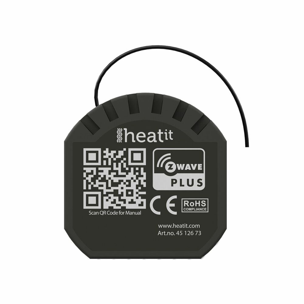

I only now saw thet the Z-TRM3 is a full thermostat. What i need is just a module without a display. So something like the Heatit ZM2 thermostat.
I havnt been able to discover online if a similar firmware upgrade is available for the ZM2 is needed and availabe.
Hope someone knows this.

Maybe that is a possibility but it should be a switch with a relay in order the switch the high current that the electrical heating element consumes. Not sure which module would be suitable and which temp sensor to link and how.
The existing floor thermostat has a temperature sensor in the floor. I like to re-use it. Also that module, which doesn’t work anymore, is “hidden” in the wall of another adjacent room. So all the wiring is in a different room than where the floor heater is. I can’t change the wiring without major demolition work in the existing rooms. My plan always has been to use a module that can switch the high current based on the measured temperature in the floor and a setpoint. The setpoint I like to set with Domoticz. Possibly later on I like to add a LCD in the room that shows the current room temperature and allows a changing the setpoint via the LCD too.
So far my thoughts are that I can most easily and reliably do this with a built-in wall thermostat module, like the heatit one as described above, if compatible with Domoticz.
