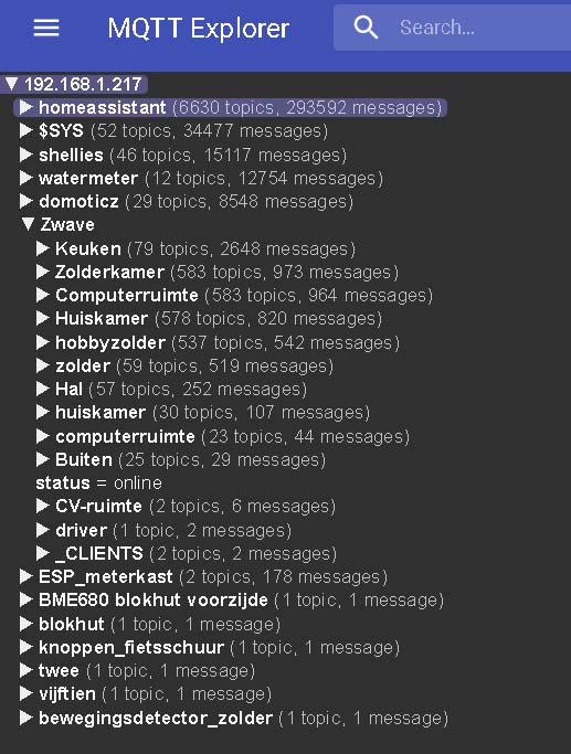

When I take a look with mqtt explorer, all the nodes are present.

I cleaned up retained messages with mqtt explorer, problem still exists, another Pi with a complete new installed Zwave JS but with the same controller, all devices present and the same issue, disconnecting.
