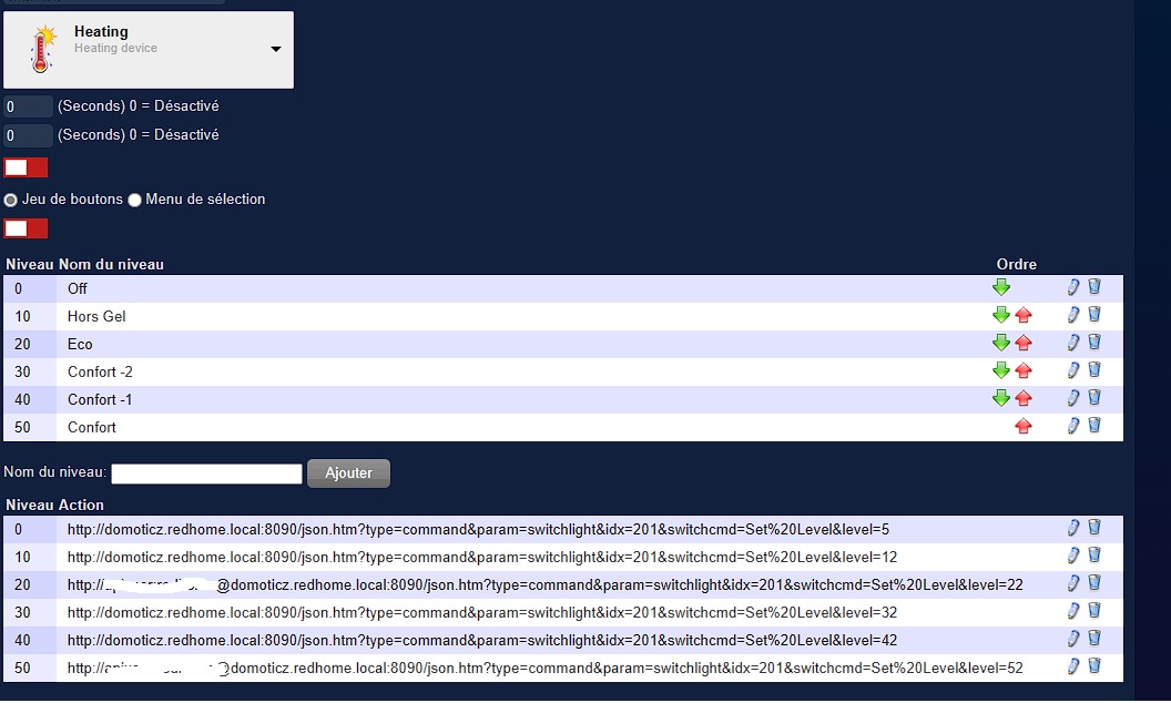

until now i was using a dummy selector to trigger a sepcific level on a dimmer , using api call :
for example on my dummy i have this level set :
10 with this action :
http://domoticz.redhome.local:8090/json ... l&level=12
so it sets level 12 on my dimmer.
everything was working until i update (from 2022.1 to 2023.1), i understand there has been modifications, soi i added authentication :
action : http://myuser:[email protected] ... l&level=12
but it is not working in domoticz (but working fine when doing a curl...) so what is wrong ? how can i get this working (without making a script call that do curl...) ?

see attachment, i have tested on level 20 and 50 without success.
but the same line in curl is working...

I do not understand what you are trying to do and what the screenshot should show?
Did you run Domoticz with the before mentioned debug flags? What was the debug output?
Make sure that you have set the correct security settings, see the changelog of 2023.1 and Wiki for more information.

As many french users he use a qubino module to drive heaters ( pilot wire mode mandatory in France) that is controlled as a dimmer for compatibility purpose.kiddigital wrote: Thursday 30 March 2023 6:40 I do not understand what you are trying to do and what the screenshot should show?
0 to 10% as off
11 to 20 as anti icing ( 7°)
Etc...
So using a virtual device to show real heater mode.

Yes exactly, i use a virtual device which modify real device through api call. But it doesn not work anymore.
