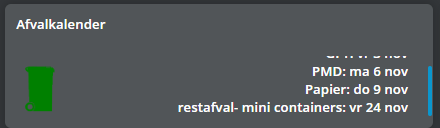

In my Domoticz CarbageCalendar I now have a strange name for the 'restafval'. It says 'restafval-mini containers'. It this something I can fix or does the plugin needs an update?
I'm using the Blink afval verwerker.
Screenshot 2023-11-02 080420.png (8.65 KiB) Viewed 4730 times

Post by jvdz »
rensbr wrote: Thursday 02 November 2023 8:05 In my Domoticz CarbageCalendar I now have a strange name for the 'restafval'. It says 'restafval-mini containers'. It this something I can fix or does the plugin needs an update?
No plugins needed, simply follow the Wiki how to change the config! ;)
https://github.com/jvanderzande/Garbage ... evice-icon
Update the text='restafval-mini containers' to what you want to see.
rensbr
Posts: 62
Joined: Friday 27 July 2018 19:01
Re: GarbageCalendar (new version) lua scripts
Post by rensbr »
jvdz wrote: Thursday 02 November 2023 15:01
Ah great. It works again like it should. Thank you for the support and fast reply!
