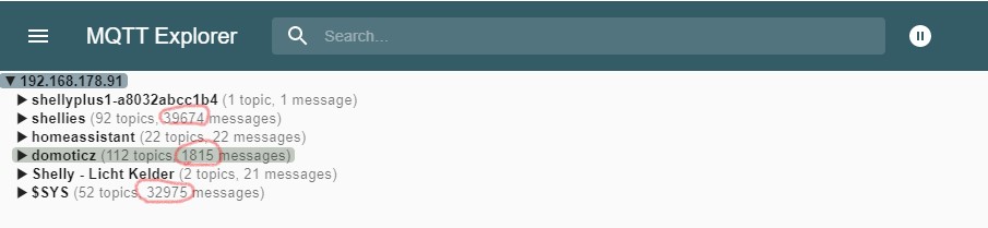

I have a strange behavior with mqtt auto discover and shelly blinds.
When the blinds are OPEN I get a flood of logging (OPEN, CLOSE,...)
When I close my blind, (Kris:(IP:...), there is one logging OPEN and CLOSE and then it stops. But when blinds
are back open I get a flood off logs , (OPEN , CLOSED, ...)!
And the user is mqtt auto discover :shock:
Is this a error or ? See screenshots
I used the latest ShellyTeacher for adding my shelly devices. Great work !

Add some more info with screenshot from mqtt explorer
mqtt explorer.jpg (28.71 KiB) Viewed 2840 times

capman wrote: Wednesday 01 November 2023 13:14 I have a strange behavior with mqtt auto discover and shelly blinds.
(edit)
I know what the problem was. Accept new hardware/sensor was enabled. As soon I disable it the logs stopped 8-)

capman wrote: Tuesday 07 November 2023 17:16 I know what the problem was. Accept new hardware/sensor was enabled. As soon I disable it the logs stopped 8-)
I hope you also stopped ShellyTeacher, as running continously is not needed.

lwolf wrote: Tuesday 07 November 2023 17:22
I did :D . The problem was that I enabled a notification for the action blinds closed. So I get repeately a flow of blinds closed :? .
As soon a enable 'accept new hardware' , I get again notification flood when the blinds are open.

what can be wrong?
Shelly plugin or Shelly Teacher script? For teacher script use topic viewtopic.php?t=40998
