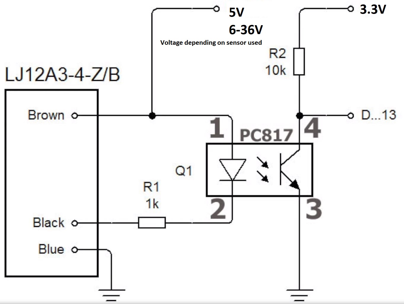

i am using a nodemcu unit buy a wemos-d1-mini will work as well
it is running ESPeasy software
as a sensor i am using a LJ12-A3 proximity sensor which picks up magnetic disturbance
this thread will help you
i did not use a voltage converter but i used an optocoupler
https://www.twoenter.nl/blog/smarthome/ ... -domoticz/
Gravityz
Posts: 755
Domoticz version: 2026.3
Re: how to copy data from watermeter to waterflow
Post by Gravityz »
i am using a nodemcu unit but a wemos d1 mini will work as well
input NodeMCU and Wemos D1 mini both have 3.3 inputs
sensoren work correctly on 5V
attach sensor to 5V but inputs through a pullup resistor to 3.3V

Thank you so much for the detailed information.
Debian buster on NUC and three RPi with buster.
Gravityz
Posts: 755
Post by Gravityz »
your welcome.
to be more specific, i checked and i have the sensor hooked up to D5(not D13)
