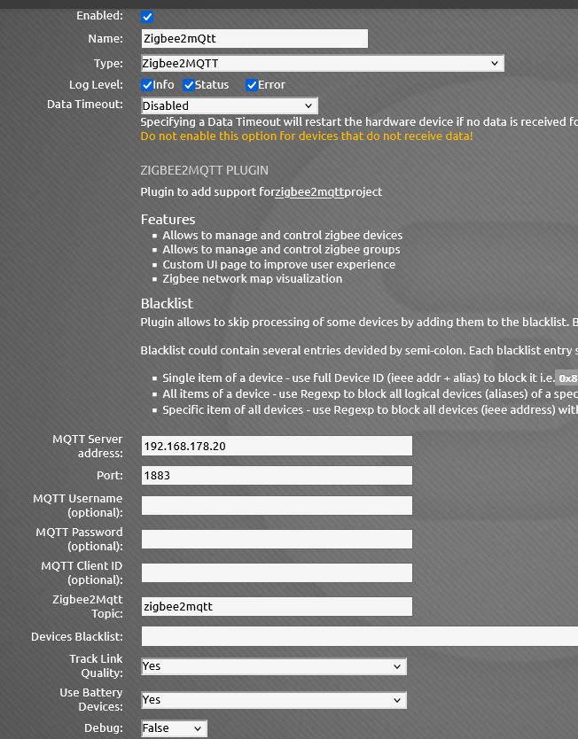

hi all,
I've installed Zigbee2MQTT based on Stas' git repo
I've also tried to follow instructions on several (older) youtube video's.
What I saw is that after adding the hardware in Domoticz, I should have an option 'Zigbee pairing'
However, that option is not presented.
Am I missing something? or could this be versioning differences?
The only thing under devices that showed up is "Zigbee2mQtt api_transport 255 Zigbee2MQTT API Transport
Eventhough that was instructed, Im not sure how to continue now.
Any idea's?

Thanx, I've had a previous setup, but that didn't work anymore, so I thought I'd start over.
I've followed the nstructions for Autodiscovery, however I don't seem to have the /opt/zigbee2mqtt directory :(

I see. Unfortunately the interface is not available either.
So, both the python plugin as well as the auto discovery mode aren't working for me
I do have to admit that I've bypassed the Docker imagery and installed straight on the pi. Could that be an issue?

ok, this says up and running
 zigbee2mqtt.service - zigbee2mqtt
   Loaded: loaded (/etc/systemd/system/zigbee2mqtt.service; enabled; vendor preset: enabled)
   Active: active (running) since Wed 2023-09-13 17:44:11 CEST; 562ms ago
 Main PID: 6255 (node)
    Tasks: 6 (limit: 3860)
   CGroup: /system.slice/zigbee2mqtt.service
           └─6255 node /usr/bin/npm start

Eventhough it says up-and-running, my devices are nowhere to be seen :?
