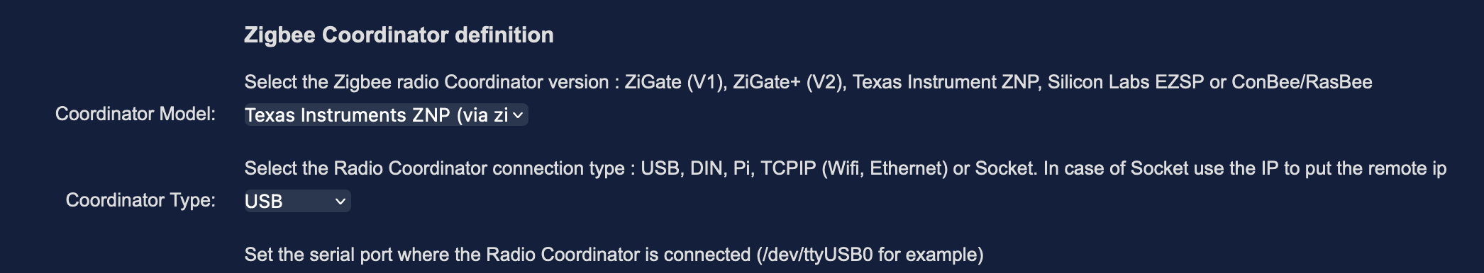

On the web page of the module I get this error:
Module: "Plugin"
nwkid: "None"
PluginHealth: "Startup"
message: "[ 70] I have hard time to get Coordinator Version. Mostlikly there is a communication issue"
Any idea? Should I be using ACM1 as a USB device? I tried, but no visible improvement :(
Is "baudrate=115200" the right speed?
Cheers, Jan

For the plugin Instance what did you put for Coordinator Model ?
Screenshot 2023-08-23 at 20.19.06.png (116.96 KiB) Viewed 3879 times

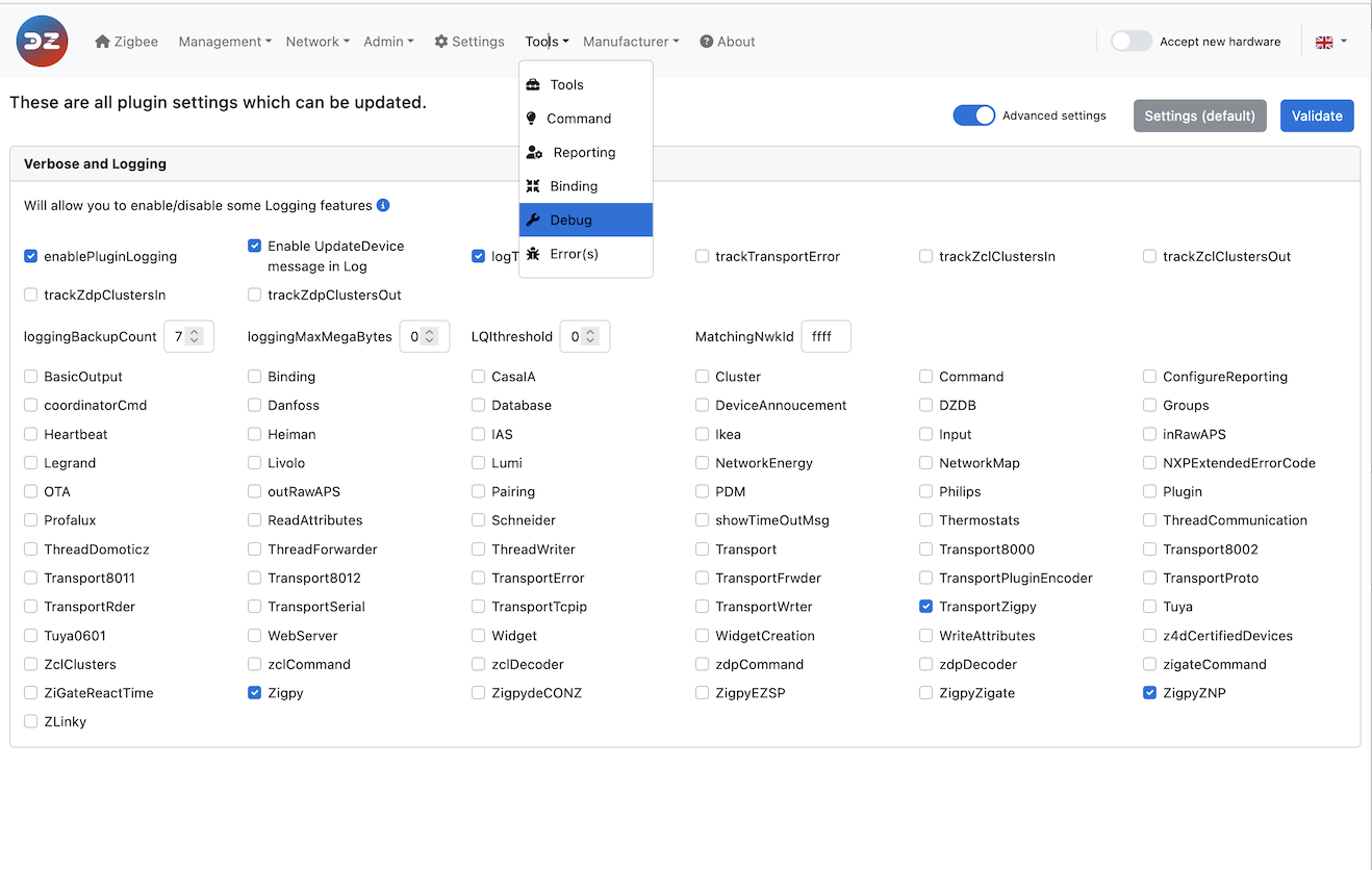

For the debugging part here after is what I would recommand
Screenshot 2023-08-23 at 20.18.14.png (257.73 KiB) Viewed 3879 times

pipiche wrote: Wednesday 23 August 2023 20:20 For the plugin Instance what did you put for Coordinator Model ?
Ah, bugger... I had it on Zigate.
When I set it up properly on a second plugin instance it still did not want to work - it told me to:
