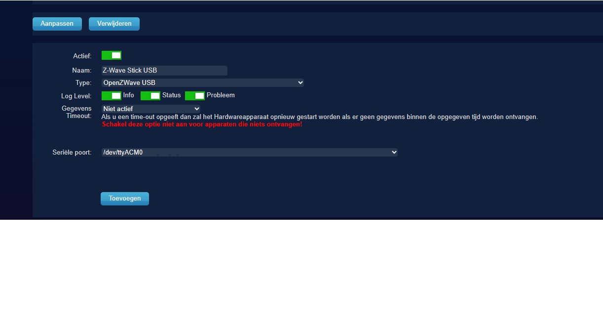

I see now that i cannot see the zwave aeontec zwave stick settings in the hardware. I can set on off the switches. thats working bur i cannot see the network etc. I run domoticz in docker on a raspi 4B+

zwave stick no settings

Did you cleared your browser cache? Or tried in a private browser mode?
OpenZWave is removed from the current beta version and will also be removed from feature stable releases.
You should switch to zwave-js-ui with MQTT Auto discovery (docker compose)

yes it works now but, what is the rationale behind removing the z wave plugin? this is easy as it is now. it works out of the box.

The Openzwave project that Domoticz uses is not maintained anymore: https://github.com/OpenZWave/open-zwave

Zwave-JS-UI also supports the newer Zwave controllers 700 and even 800 etc. But this has already been discussed numerous times.
If you want to stay on OpenZwave stay on Stable 2023.2 or make your own fork and build of Domoticz and keep OpenZwave embedded.
