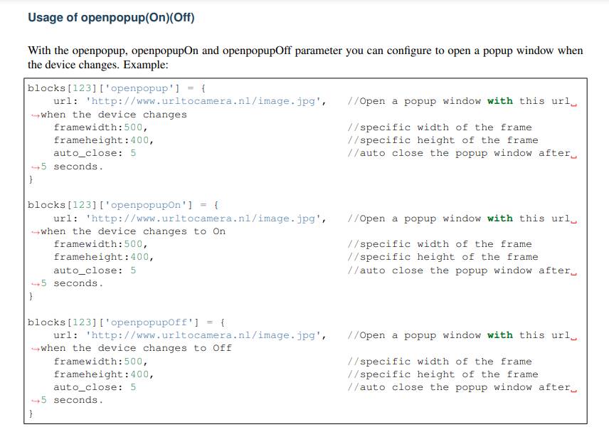

Firstly, my Dashticz version is over 2 years old, here's the relevant section from the documentation for that time. If its no longer accurate, someone please correct.
Dashticz Documentation.jpg (58.8 KiB) Viewed 943 times

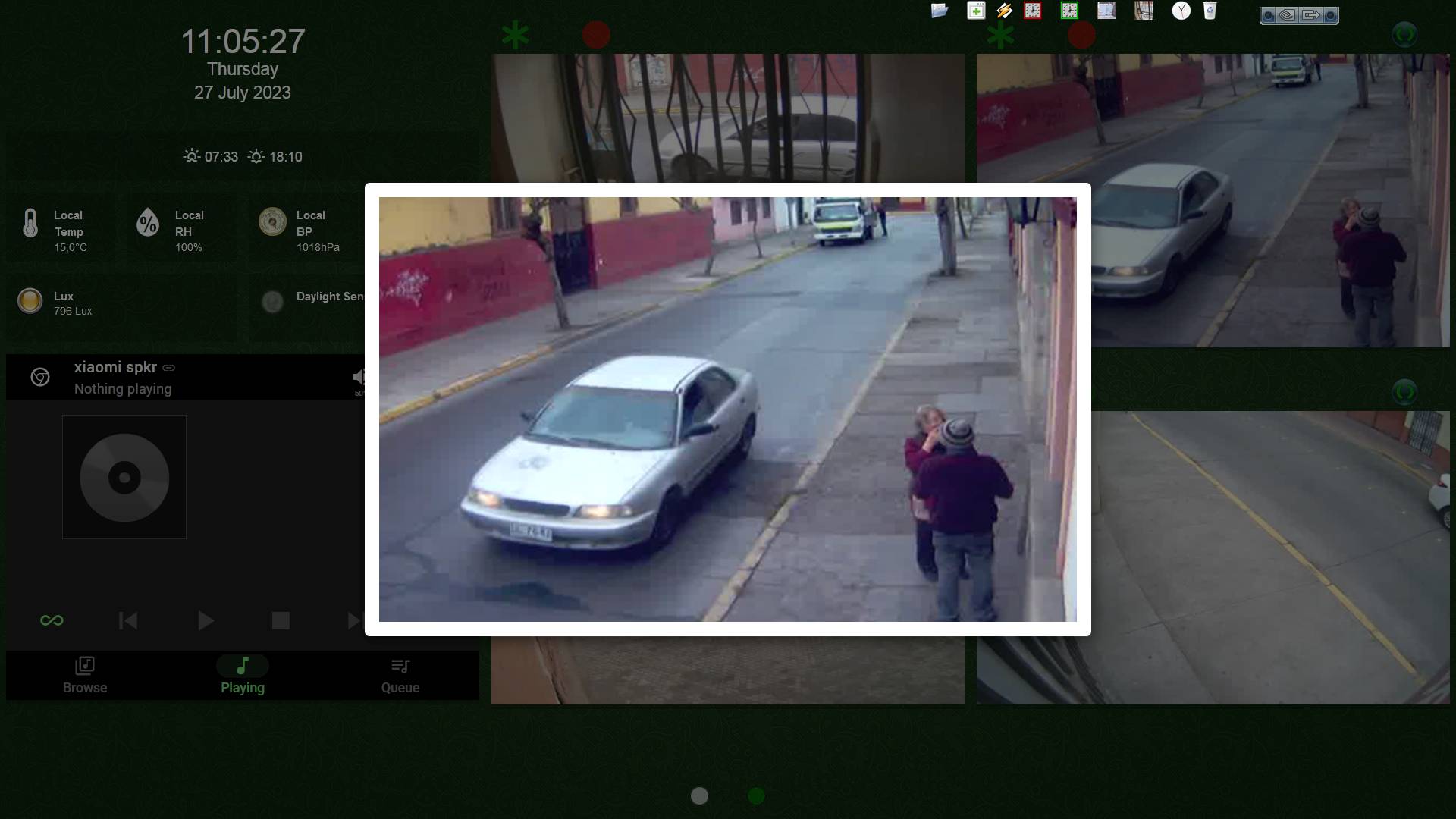

Here's a manually-triggered video popup example from another camera.
