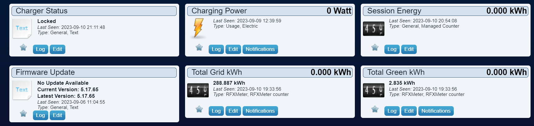

I've created a plugin for integration of the Wallbox EV charger into Domoticz.
The plugin uses the Wallbox API.
See:
https://github.com/lokonli/domoticz-wallbox
Verstuurd vanaf mijn SM-A526B met Tapatalk
See:

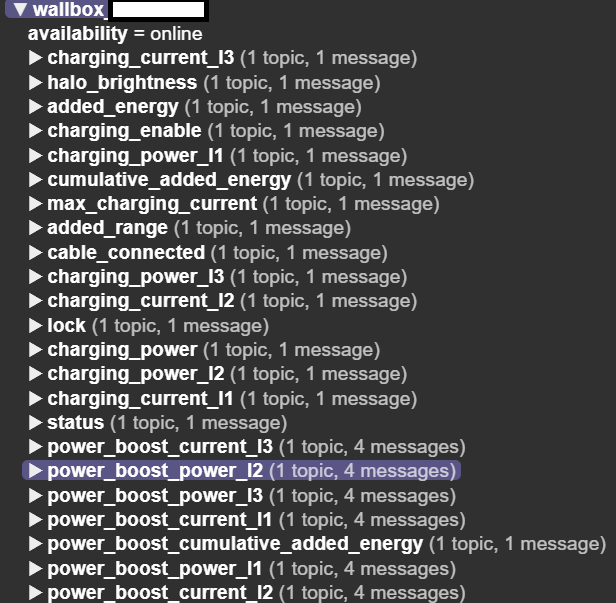

Found this trick.
https://github.com/jagheterfredrik/wallbox-pwn
together with:
https://github.com/jagheterfredrik/wallbox-mqtt-bridge
It allows you to obtain full control and all data locally from the Wallbox without breaking the Cloud functionality.
It publishes data to MQTT every second.
We could add this to a separate plugin or use something like a ShellyTeacher4Domo kinda approach to automatically create these devices in Domoticz.
together with:

Or use the mqttmapper plugin. I think this would be the easiest way.

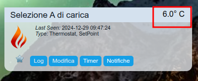

Really nice plugin ( and easy as well
Is there possible to change thw counter and set the ramp of changirng Amps instead of °C?
Could you please suggest actions?

You can do that yourself to click on the edit button and change C in A.
It could be that the plugin reset it to its default and then it is up to the plugin author to create a correct setpoint device.
