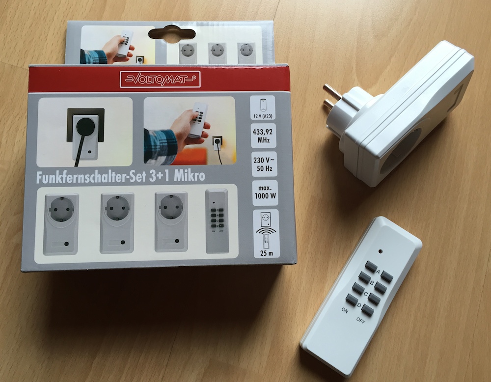

Hi there,
On the Conrad site it will not show whether they are RSL 2 or RSL 3 type when you look them up or buy them.
I bought 4 outlet switches and a remote for around 25,- euro, 2000W per switch wich you simply insert into a wall outlet (<0.5 W standby) ..no problem I thought.
But even with the undec mode switched on in the RFXCOM tranceiver, they won't show up.
After a bit of reading and checking the appliance, I discovered that I had bought RSL366R switches.
I'm guessing that they are brand new RSL types and RFXCOM firmware (my receiver is at firmware 71) will not decode them properly at this point in time.
So my tip's:
- look at the back of the Conrad RSL switches and find the model no.
- try the 'undec mode' on (look for options, hardware, RFXCOM setup mode, check the undec on box, save.. Then go to the Domoticz log (options -> log) and press the remote for the switches. If nothings appears you won't get a chance to use them in Domoticz (don't forget to uncheck the 'undec mode' after this discovery tour)
- If you have an RSL 3xx model, hope that future versions of the firmware of the RFXCOM device will support it (I am sure you could even drop them an email)
So my tip's:

The Conrad set (order number 034911) does not use RSL coding despite of the type indication RSL366R!
This set can be controlled using Lighting4. The code table has been added to the RFXtrx User Guide.
Receive for the remote will not be added.

I just would like to share that I found a "dirty" way to operate these Conrad RSL366R devices using rfxcmd (https://code.google.com/p/rfxcmd/)
Using rfxcmd Domoticz can operate these devices using OS cli commands. The reason why this is a dirty trick is because rfxcmd hijacks the serial interface of the RFXCOM device causing Domoticz to loose its connection with the RFXCOM transciever.
Domoticz logs the following messages:
2015-04-11 15:11:36.113 Error: Serial Port closed!... Error: End of file
2015-04-11 15:11:37.092 RFXCOM: retrying in 30 seconds...
Fortunately Domoticz automatically reconnects to the RFXCOM device but please be aware that this is causing an interruption in the communication between Domoticz and the RFXCOM device every time you switch a Conrad RSL366R device.
Though it's not perfect it does work without any alternatives available. (As far as I'm aware)
Hopefully the developers of Domoticz will find some time to invest in the implementation of manually adding lightning4 devices so rfxcmd can be skipped.
More information about this topic/request can be found in the following thread: http://www.domoticz.com/forum/viewtopic ... 449#p24449
This is how it can be done.
1. Install and configure rfxcmd like described in their documentation.
2. Create a switch (E.g. a Dummy or use the autolearn feature to register a remote control)
3. Install a lua script in domoticz/scripts/lua that takes care of executing the correct cli commands.
An example:
script_device_switchConrad.lua:
-- script name : script_device_switchConrad
-- This script will trigger a command every time the Domoticz switch changes status
if (devicechanged["Switch1"] == 'On') then
print "Switched Conrad1 On"
os.execute ("/opt/rfxcmd/rfxcmd.py -s 0913000354155501A950")
if (devicechanged["Switch1"] == 'Off') then
print "Switched Conrad1 Off"
os.execute ("/opt/rfxcmd/rfxcmd.py -s 0913000354155401A950")
if (devicechanged["Switch2"] == 'On') then
print "Switched Conrad2 On"
os.execute ("/opt/rfxcmd/rfxcmd.py -s 0913000354455501A950")
if (devicechanged["Switch2"] == 'Off') then
print "Switched Conrad2 Off"
os.execute ("/opt/rfxcmd/rfxcmd.py -s 0913000354455401A950")
if (devicechanged["Switch3"] == 'On') then
print "Switched Conrad3 On"
os.execute ("/opt/rfxcmd/rfxcmd.py -s 0913000354515501A950")
if (devicechanged["Switch3"] == 'Off') then
print "Switched Conrad3 Off"
os.execute ("/opt/rfxcmd/rfxcmd.py -s 0913000354515401A950")
if (devicechanged["Switch4"] == 'On') then
print "Switched Conrad4 On"
os.execute ("/opt/rfxcmd/rfxcmd.py -s 0913000354545501A950")
if (devicechanged["Switch4"] == 'Off') then
print "Switched Conrad4 Off"
os.execute ("/opt/rfxcmd/rfxcmd.py -s 0913000354545401A950")
return commandArray
In this example I am using the configurable channel IV but you can always adapt the codes like described in chapter 14.4 of the rfxcom userguide:
http://www.rfxcom.com/WebRoot/StoreNL2/ ... _Guide.pdf
Just convert the described BIN values to HEX using e.g. a calculator app and replace these values in the used examples: rfxcmd.py -s 0913000354545401A950
Names like "Switch1" should be replaced by the name of your switch defined in Domoticz.
Testing rfxcmd can be done manually using the cli command directly e.g.: /opt/rfxcmd/rfxcmd.py -s 0913000354455501A950

Similar lightning4 problem with RFXTRX433
Hi together,
i have an similar problem. I've bought some new - cheap - sockets from Voltomat (Bauhaus Germany).
They works with lightning4. But i didn't get work them with domoticz.
So - can i get this working with a lua script like xtenz have done?
Thanks for a little bit help
This are the sockets: This the code which i've received with RFXmanager:
When i press "ON A":
Packettype = Lighting4
subtype = PT2262
Sequence nbr = 30
Code = C3B970
S1- S24 = 1100 0011 1011 1001 0111 0000

patvandijk
- Posts: 8
- Joined: Thursday 10 April 2014 17:20
Re: RFXTRX433 and Conrad RSL
I was able to add the Conrad RSL33T manually by adding it as RisingSun.
Just cycled through all combinations to check which one worked.
My transmitter broke, so I was not able to use the autolearn anyway.
- 2016-01-07_11-50-20.jpg (16.08 KiB) Viewed 12105 times
vermonden
- Posts: 1
- Joined: Saturday 06 February 2016 8:37
Hello, I have the same problem like bewo. I have a Voltomat (Bauhaus Germany).
What should I do to get this working in Domoticz?
