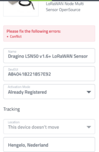

Furthermore, for setup of CayenneLPP the registration at the Cayenne-website also is/remains a hurdle,
but that might be resulting from / related to the problem described above.
At end of Cayenne-Registration_Step1, it is required to insert an Address/Location.
Used various info copied from the TTN_Console and other 'inventions', but no luck:
if trying one of the IDs containing a textstring toulon (which is the name of the street I live), the setup is accepted as valid, but the result is showing on the map as an address in the harbour of Toulon(France), at Network Acklio, which both is far 'out of range' and not useful ....
Inserting a short, real geolocation the resulting error report is 'Confict', as shown below.
A longer string comprising a practical set of <Streetname>,<Place>,<Country> is recognized by the software, but still stop with error 'Conflict', and no device found.
Screenshot_Step1_Cayenne
screenshot-cayenne.mydevices.com-2023.03.23-Registration [320x200].png (19.06 KiB) Viewed 1759 times
Apparently must have missed a few 'subtleties' in the setups.
1. What could be wrong for the TTN_PayloadFormatter-setup?
2. What is for Cayenne_Registration correct format&contents and/or data-source for Address/Location?
