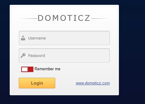

A few days ago I updated Domoticz. After that, not like before, the Dashboard will appear, but a login screen. (see appendix).
I wouldn't know with what data I should log in.
How do I get back to the Dashboard?

- Domoticz.JPG (21.41 KiB) Viewed 593 times

Since version 2023.1 Domoticz uses a login (default admin/domoticz) tho login. Setup trusted networks in setup settings security to not have to login every time. See wiki.
https://www.domoticz.com/wiki/Getting_started
