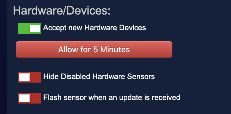

When disabling a hardware device, the visibility of its devices depends on the setting 'Hide disabled hardware sensors'. It is mentioned in the instruction ( https://www.domoticz.com/wiki/Zwave-JS-UI ), the note in the migration part.
Scherm­afbeelding 2023-08-18 om 08.43.55.png (57 KiB) Viewed 3971 times
