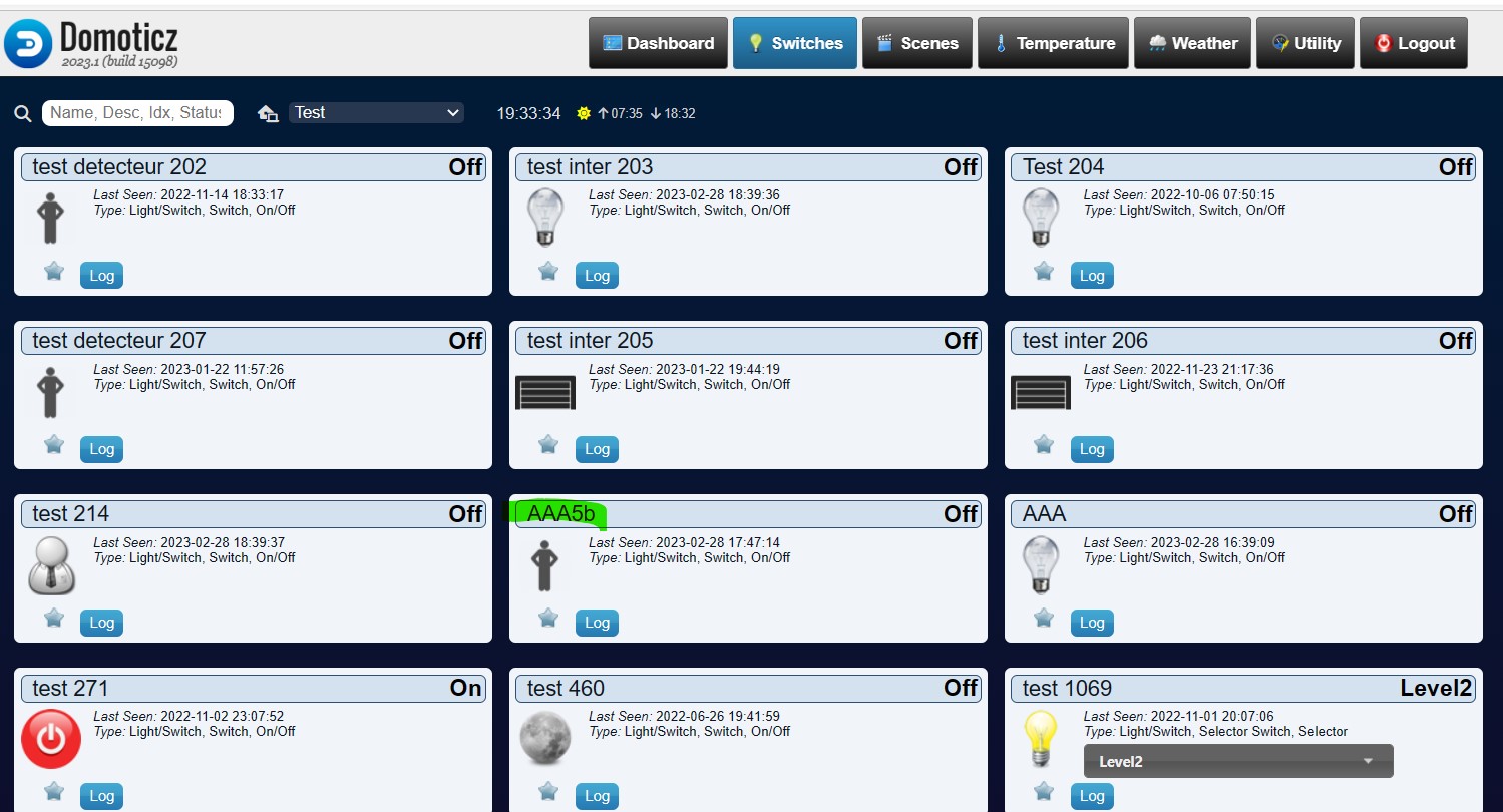

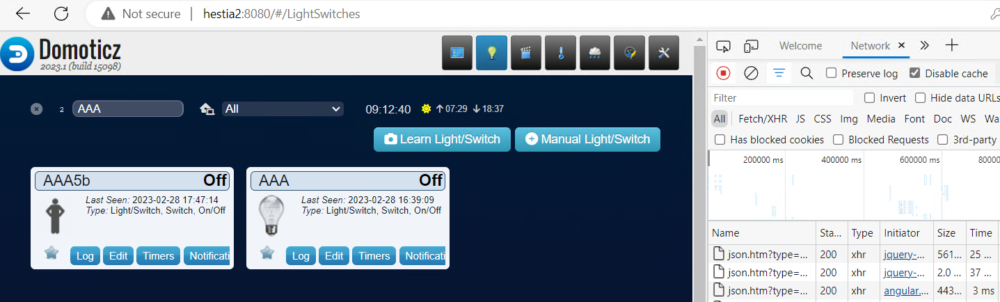

I've got a similar issue.
Not all devices have disappeared but only the new ones!
ersion: 2023.1 (build 15098)
Build Hash: 867c4e8fa
Compile Date: 2023-02-24 07:56:50
dzVents Version: 3.1.8
Python Version: 3.9.2 (default, Mar 12 2021, 04:06:34) [GCC 10.2.1 20210110]

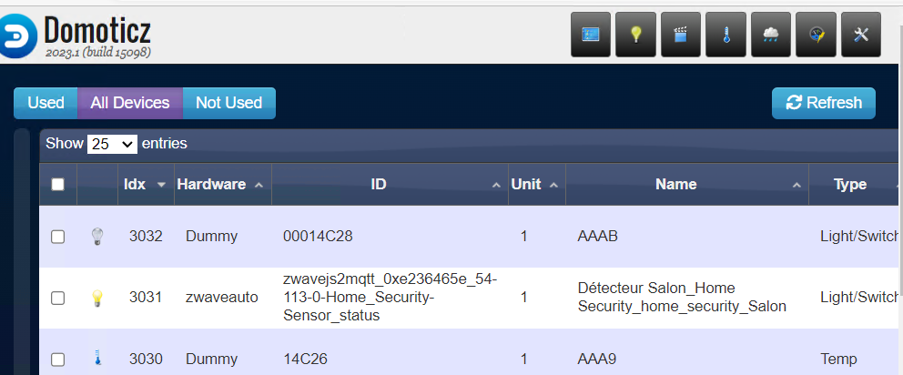

Just before I was with the release 2023.1 ; I upgraded to the last beta to check if this issue has disappeared! Not :-(
I've added a dummy, present in the list of the device, not in the Switches tab.
Also with the iDetect pluging, but with the iDetect plugins I could see the device if I put it in a plan and use the select list

I've tried with 3 <> browsers (Edge, Chrome, Firefox) and cleared the cache.
I had the devices that were present before the upgrade (but didn't check them all).
The upgrade was in fact a new install on a new server, where I've copied a backup of the DB.
What else to do?

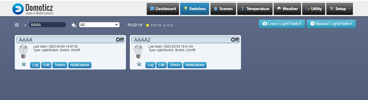

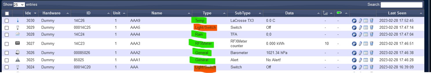

Some more testing:
I've created sensors in each tab: Switches, Temperatures, Weather, Utility
The result:
Screenshot 2023-02-28 175559.jpg (96.24 KiB) Viewed 3081 times
So only the switches does not appear !?!
I don't know if this could help to solve this issue

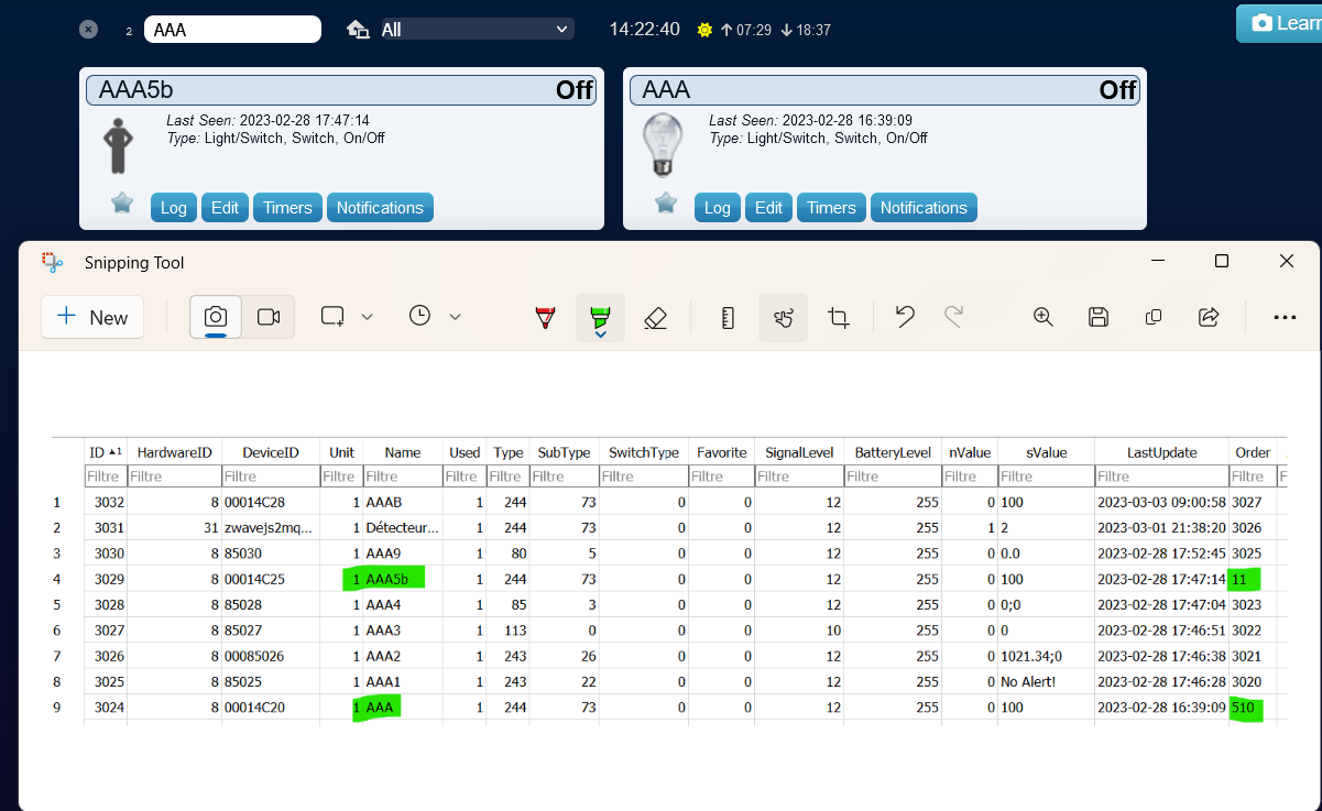

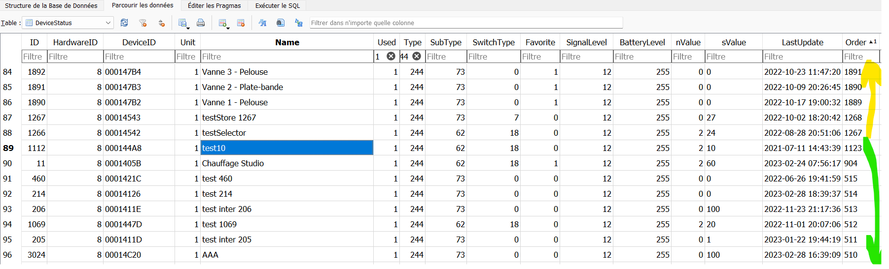

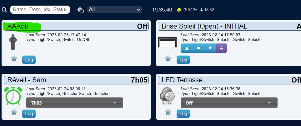

I think I could say it is a real bug...
My new switch devices had a bigger order than the existing ones
For instance the AAA5 idx=3029 had his order=3024 (Order, ie the column in the DeviceStatus table)
When I went to the Rom Plan, I could make it go upper in the screen, and I could see it in the device tab with the filter on the Plan :)
Screenshot 2023-02-28 193350.jpg (229.31 KiB) Viewed 3075 times
But not yet with "All"
Then I run this sql update
sqlite3 domoticz.db "UPDATE DeviceStatus SET [Order]=11 WHERE ID=3029"
(not so cool Order is a reserved word!)
And the device jumped at the top of the screen!
Screenshot 2023-02-28 193606.jpg (84.67 KiB) Viewed 3075 times
What is strange is that I could be the first to have more than 3000 'Order'...
Or perhaps I'm the first with this and to add devices (switches) with this version...

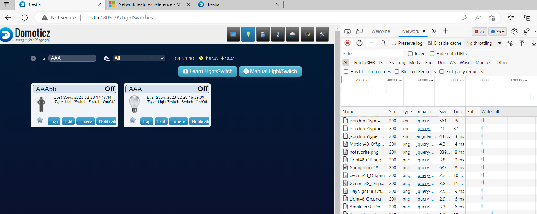

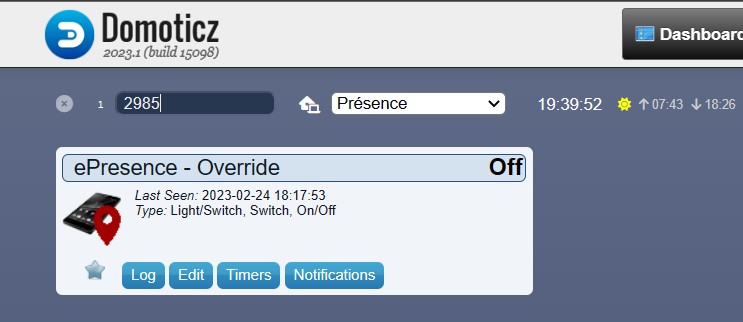

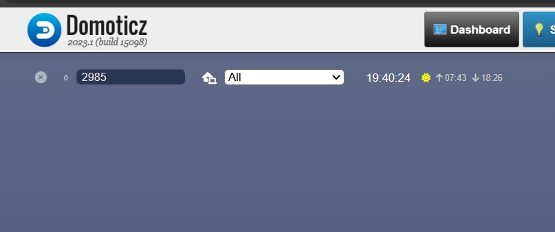

kiddigital wrote: Tuesday 28 February 2023 19:18 Try to browse the Domoticz UI with the ‘developer tool’ (F12) active. Make sure you are on the ‘network’-tab and select ‘Disable cache’.
Now browse through everything until everything seems ok. Now all webassets should be fully reloaded.
I've done the test right now.
New computer set up yesterday
Cache disabled
Same result (AAAB is not displayed)
Screenshot 2023-03-03 085421.png (321.87 KiB) Viewed 3047 times
Screenshot 2023-03-03 090115.png (92.11 KiB) Viewed 3047 times
Screenshot 2023-03-03 091252.png (204.12 KiB) Viewed 3047 times
After adding the device in a plan and moving up before the "old" ones it appeared ; so for me it's more a data / code subject than a cache subject

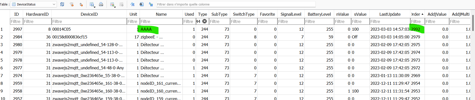

I'd say that it's not only the new devices created with the new version but also the previous ones (but, I had installed some betas previously...)
Before the Order 1123 (included) they appeared, after 1123 I could not seem them! (I did this test on samples around the breaking line)
Screenshot 2023-03-03 143323.png (69.9 KiB) Viewed 3011 times
I could send you my DB (16MB) if it can help...

what is strange is that it works on my prod env with also high Order values !!!
Screenshot 2023-03-03 150057.png (63.6 KiB) Viewed 3006 times
Screenshot 2023-03-03 150219.png (67.94 KiB) Viewed 3006 times
prod
About Domoticz
Version: 2022.2 (build 15022)
Build Hash: af4316cb7
Compile Date: 2023-02-03 16:33:14
Python Version: 3.7.3 (default, Jan 22 2021, 20:04:44) [GCC 8.3.0]
test
About Domoticz
Version: 2023.1 (build 15098)
