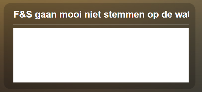

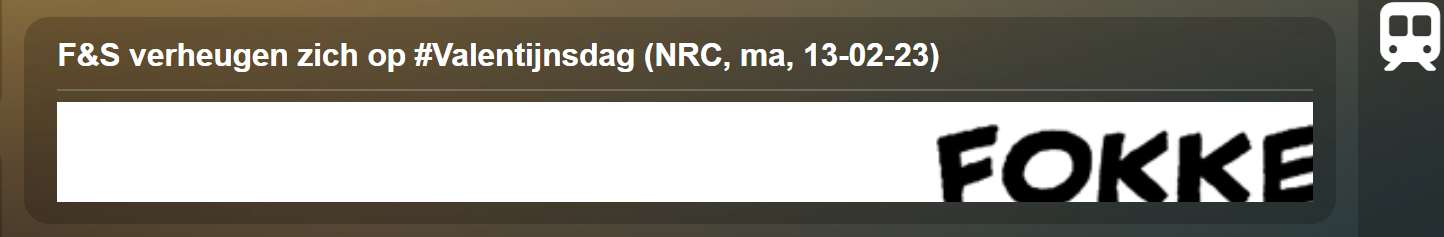

I am trying to add a RSS feed in Dashticz. The RSS is a catoon and therefore needs to be in a small block.
The feed itself works.
blocks['FokSuk'] = {
        feed: "http://rss.xiffy.nl/cache/foksuk.xml"
This gives;
When i set a width of 6 i get;

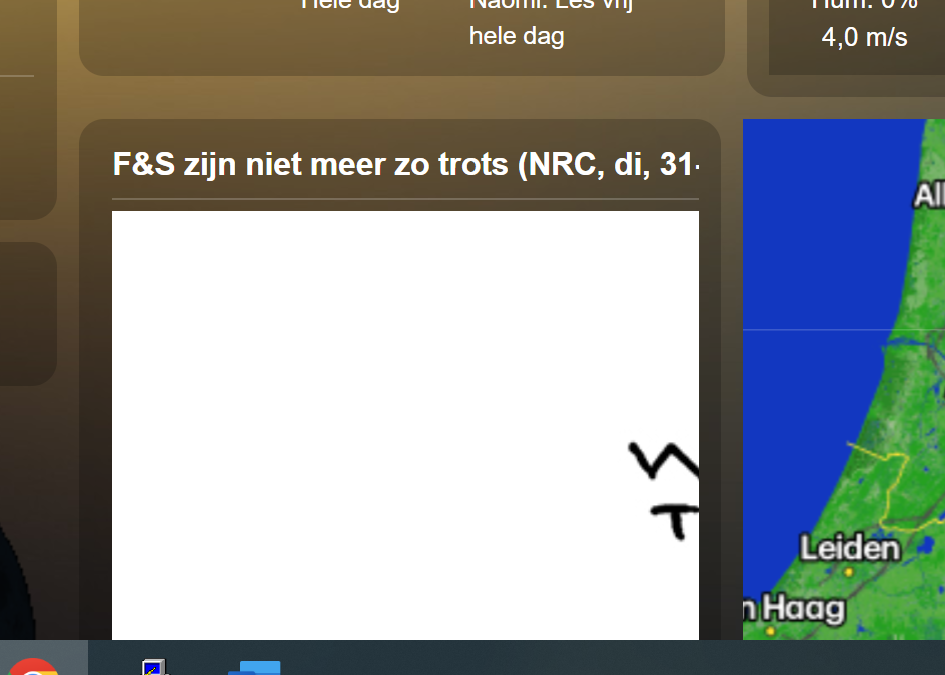

I can also set a height but everything below 500 (even 499) gives the same image as the one above.
When is set the height to 500 the block dropes down out of picture (probably to the original image size)
When i set 'scaletofit' to 256 and aspectratio to 1, nothing happens.
When i set block size in CSS the block size is correct
.dt_block[data-id='FokSuk'] {
 height:295px !important;
 width:295px !important;
But the image is still droping down out of sight (to the original image size

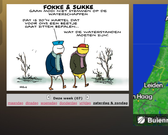

Decided a 'news' block with RSS feed was not the way. Used var frames instead with the website url "www.foksuk.nl"
I first searched different fora and watched YT videos to understand how to make an iframe of a website since my coding skills are not that good.
I came up with;
<!DOCTYPE html>
<html lang="en">
<head>
	<meta charset="UTF-8">
	<meta name="FokSuk" content="width=device-width, initial-scale=1.0">
	<title>Fokke en Sukke</title>
	<style>
			.iframeContainer{
				position: relative;
				width: 500px;
				height: 800px;
				overflow: hidden;
			.iframeContent{
				position: absolute;
				top: -180px;
				left: -235px;
				width: 800px;
				height: 500px;
		</style>
</head>
<body>
		<div> class="iframeContainer">
			<iframe width="256" height="256" src="http://www.foksuk.nl/" scrolling="no" style="-webkit-transform:scale(0.7);moz-transform-scale(0.7);" class="iframeContent"/>
		<div>
</body>
</html>
Saved this as a HTM file and placed this file in the /img folder on my Pi.
I then setup a frame in Dashticz with the frameurl reffering to the htm file in the /img folder
var frames = {}
	frames.foksuk = {
		frameurl: "img/FokSuk.htm",
		height: 240,
		scrollbars: false,
		width: 6
The iframe was loaded in the Dashticz frame but was out of sync. I then changed the height, width, top and left pixel settings of the iframeContent in the.htm file bit by bit until the image was in center of the block.
