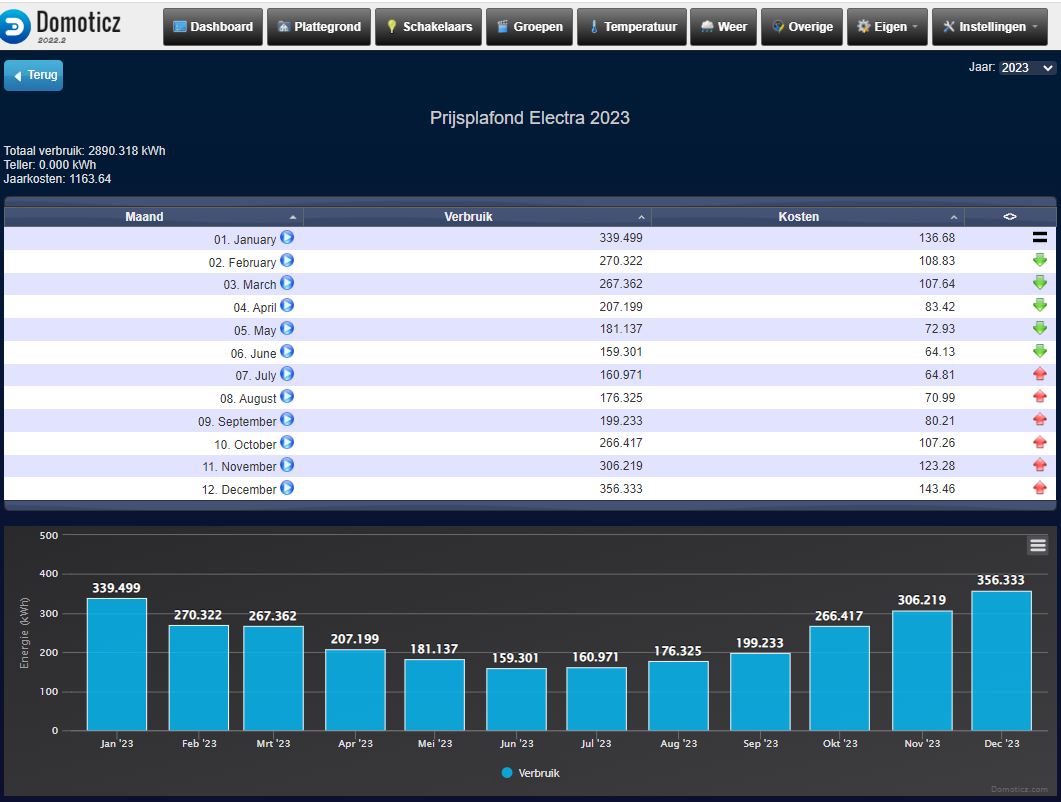

I also imported the prijsplafond values, as published on rijksoverheid.nl into the meter_calendar table for 2 dummy devices. I did this by creating the dummy devices, find their device ID and then running the following queries:
For the Gas prijsplafond values:
insert into Meter_Calendar (DeviceRowID, Date, Value)
select 1983, t.Date, t.Gas * 1000.0
from (

And for the KWh prijsplafond values:
select 1984, t.Date, t.Electra * 1000.0
from (
select 	'2023-01-01' as [Date]	,	11.321629 as [Electra]	,	7.17361783 as [Gas]

This enables me to show the following reports. Don't know what exactly to do more with it yet, but they're nice graphs :-) :
Prijsplafond Gas
Prijsplafond Gas
prijsplafond Gas.JPG (101.88 KiB) Viewed 7548 times
Prijsplafond Electra
prijsplafond Electra.JPG (113.45 KiB) Viewed 7548 times

The "usage" in that year (per day) is the value of the prijsplafond
Ok, so the only thing you did different than what i did is to load the prijsplafond data into the actual gas device, replacing the 2023 date in it with an earlier year? Isn't running my query a lot simpler? I did it in my RPI, using the sqlite3 command. Similar like you, i could have edited the query's date value and use the gas devices I'd. All without having to write and execute a python script. This shows there are always different ways to skin a cat! 😀
