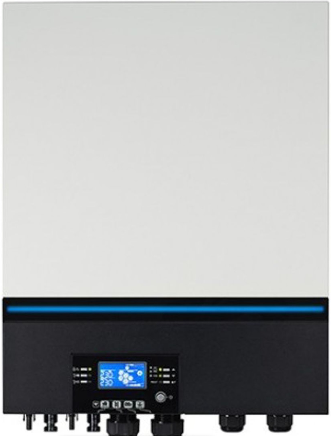

Hello from France,
I just bought and installed an AXPERT MAX 48V 8KW HYBRID INVERTER with built-in WIFI module (but defective, the seller still searching the solution, but I think the display with integrated mini-wifi card must be replaced under warranty :| )
The defective built-in wifi should work on the cloud with android APP (SmartESS, WatchPower or SolarPower ==> very similars apps)
Actually the microUSB port is working on my windows laptop with watchpower v1 14 free software.
Is is possible to have this AXPERT inverter in domoticz ? Does it exist a pluggin with the WIFI or USB connexion ?
Thanks :P
