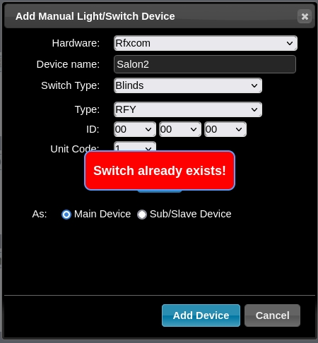

I have 4 Somfy RTS blinds since years. Since years I control those blinds with Domoticz via RFXCom.
I have tried a Somfy Box and had to reset the blinds so I could no longer control my blinds with Domoticz.
I removed all the blinds from the devices panel in Domoticz. But now, each time I try to add a blind I get "Switch already exists" and if I change Id in the add panel I can add blind but the blind is not controled by Domoticz : it says Switching open or switching closed but nothing happen.
What can I do ?
- screenDomo1.jpg (68.43 KiB) Viewed 602 times

Re: Switch already exists
Hi. Always the same issue.
If I try to change ID or Unit code I can't control the blind and here is what I get in logs :
Rfxcom: Invalid data received!.... why ? What ?
