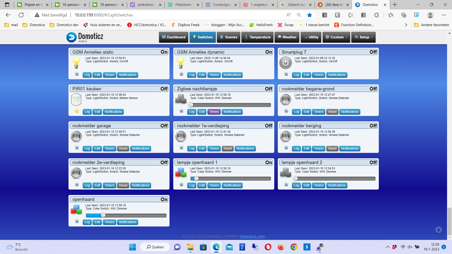

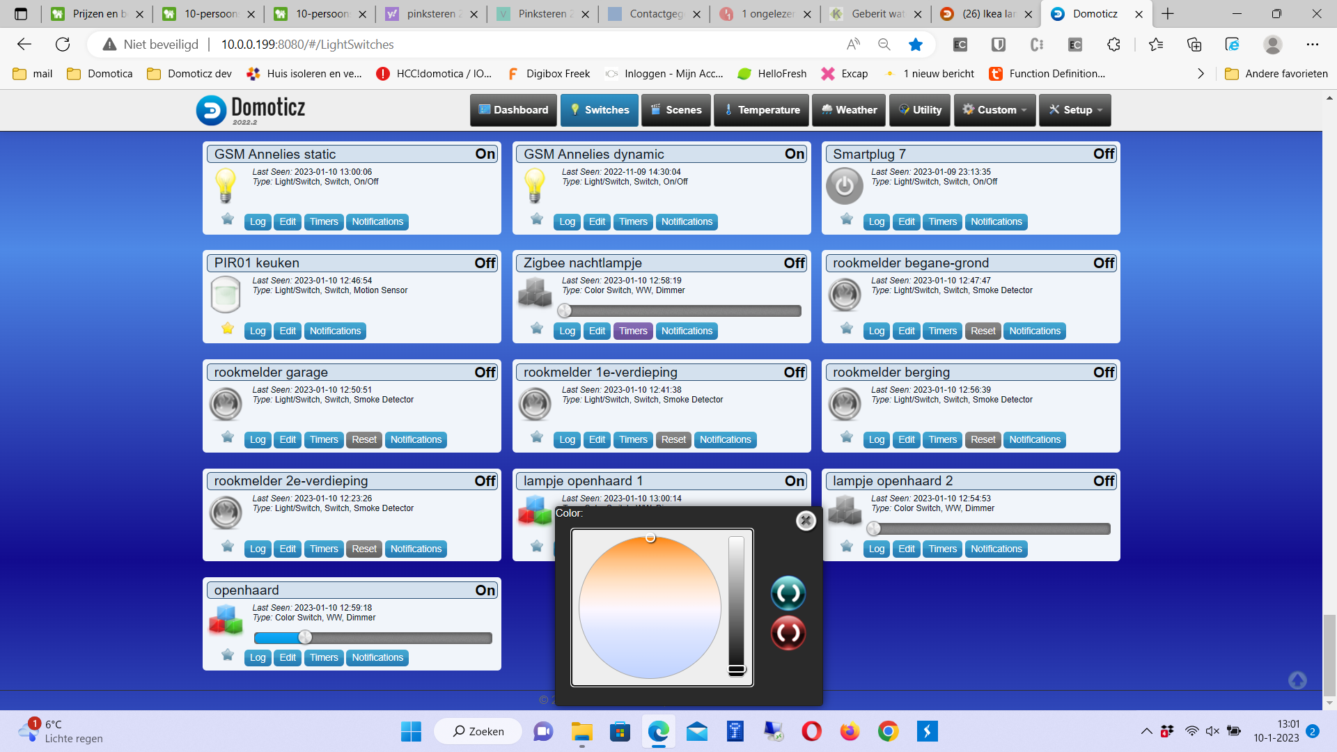

I took two screenshots. The lamp is "lampje openhaard 1".
The slider that works OK is the one that is shown on the device icon.
When I click on the device icon, a popup screen opens with the color selector, a vertical slider, and the on/off switches.
This slider does not work properly.
When I slide it up or down, I can see a slight reaction in the lamp. When I click on the slider path the lamp reacts better. Also, when I set a timer on the device, the on/off function and the color selection works OK, but the level does not.

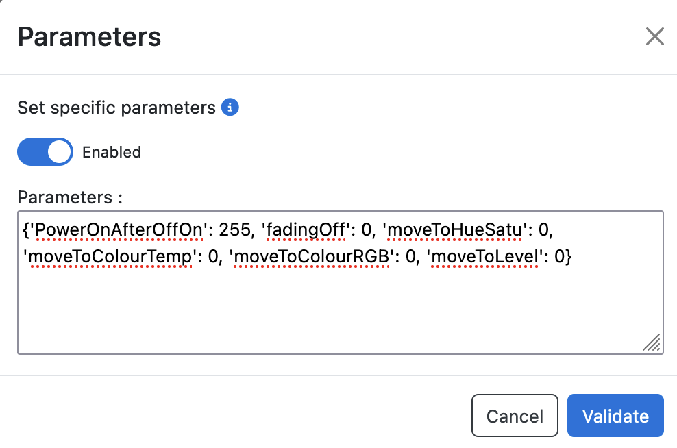

Didn't you set any parameter to get a smooth move of the level control ? You can eventually enable debugCommand ( in the debug parameters) this will increase the level of debug when doing commands from Domoticz, and you might check if they are different
I'll setup a test environment and check that

Here is my analysis.
When you slide up or down and you don't release, it looks like Domoticz is sending a command event to the plugin which is them executing the corresponding command.
So if you are moving the slider slowly you'll execute a series of commands which then will be send to the bulb.
When clicking you'll send only once.
I didn't see any behaviour differences between the two level control sliders. They work well on my system Dz 2022.2 (build 14855)
the remaining thing, is if you have set the moveToLevel parameter to 200 for exemple, it will take 20 ms for the bulb to move from its current level to the requested one in a smooth transition.
I didn't see anything on the Group side either
