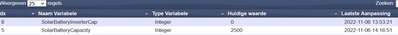

Please share your script and make a screenshot of your user variables. Problems are there to be solved ☺️
jake
Posts: 753
Re: LUA – Virtual Solar Battery: simulate the presence of a battery for storing harvested solar energy
Post by jake »
Oops, I only see now that you shared your user variables as well and there I see the problem: you chose an inverter capacity of 0 Watt. This means that your 'battery'won't be charged or used. If you don't want to deal with limitations to the amount of power that can flow from and to the battery, choose a big value of, for instance, 10000 W. That should do it.
I will have to add a warning for this in the script, to prevent this error searching, like we just did.

Hi Jake,
Yes, now it works!
Sorry for the inconvenience, my mistake, should have read better!
Thank you very much!
