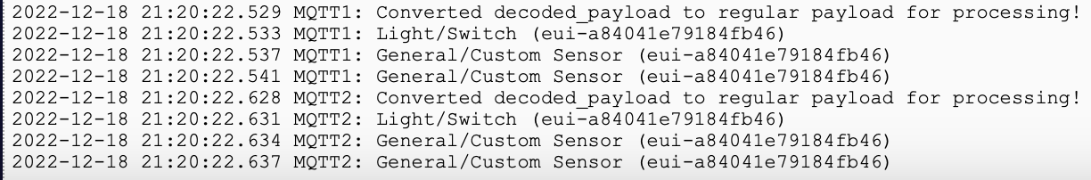

I am using domoticz to subscribe to MQTT events on thethings network, and once received, a notification is sent using Pushsafer.
On my first domoticz instance, it works fine.
On my second domoticz instance, domoticz is able to see the messages, but does not send the notification to pushsafer.
On the first instance, the MQTT logs are highlighted in green as status messages.
On my second instance, the MQTT logs appear, but are not highlighted as "status" messages
What could be causing this difference in behaviour? and how do I fix it?

- Pushsafer not working. MQTT message not "green"
- Instance 2 .png (87.01 KiB) Viewed 546 times
- Pushsafer notifications working. MQTT message is "status" message
- Instance 1.png (34.81 KiB) Viewed 546 times

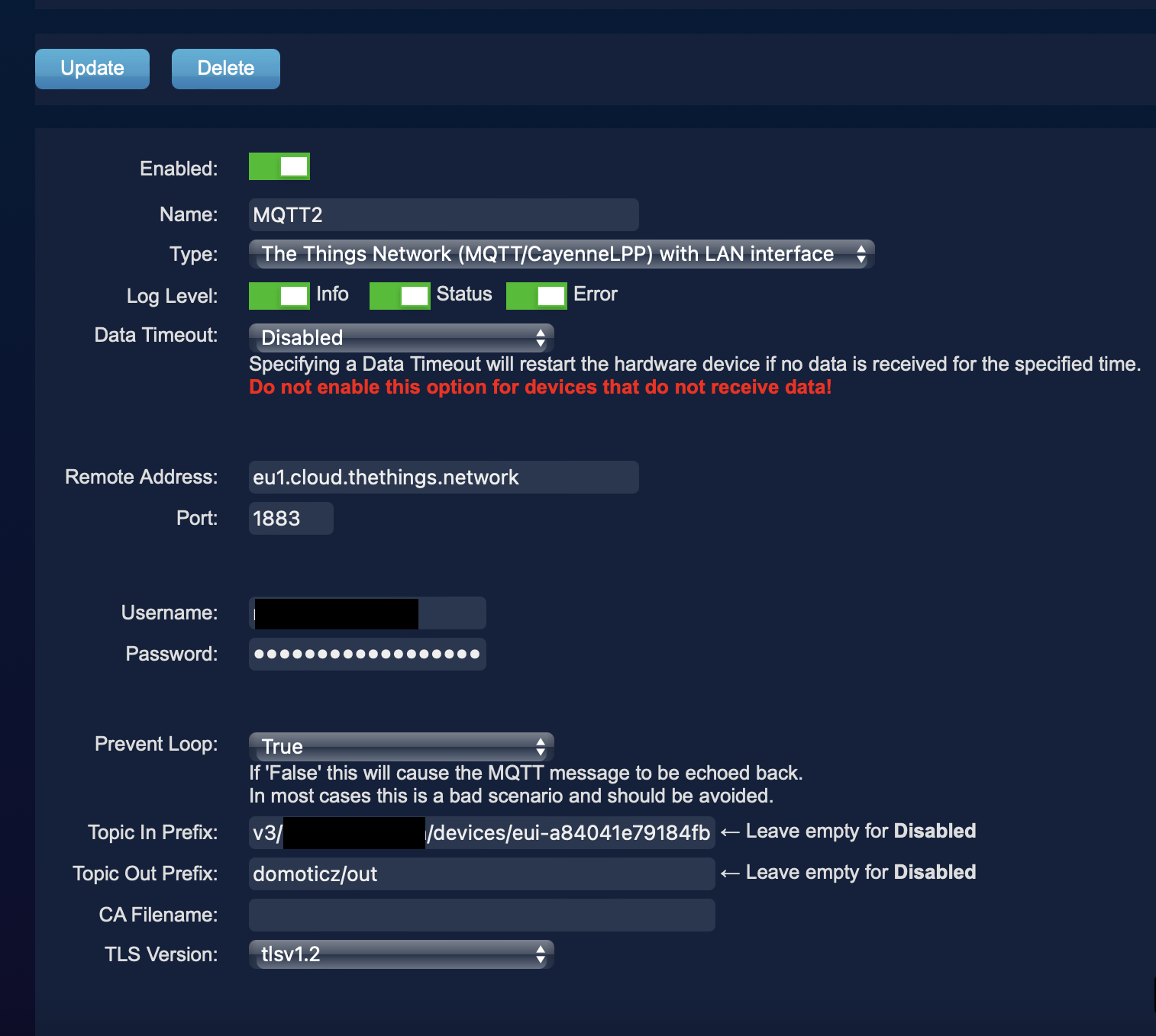

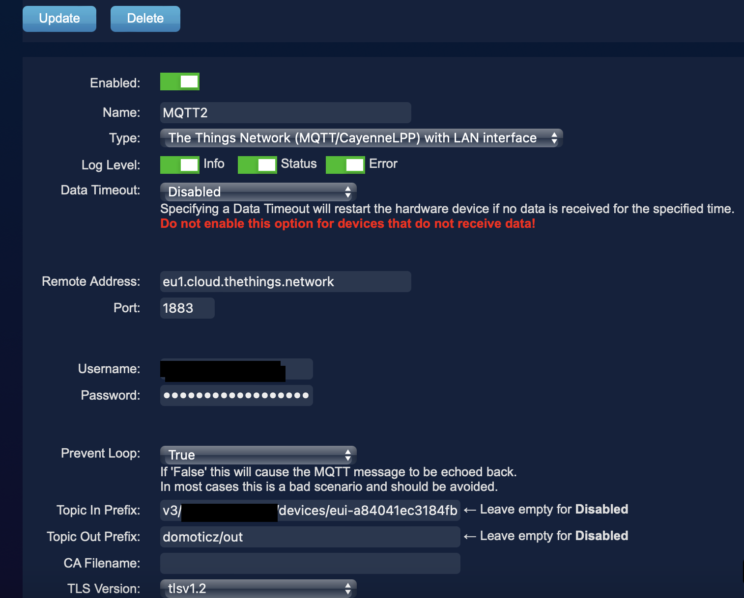

In domoticz, the configurations are the same.
I am not sure if there is any difference at the OS level.
I have attached screenshots from each instance.
Both are subscribed to the same event in thethingsnetwork.

Strange. And also the same Domoticz versions and same hardware (RPi 32, RPi 64, windows orLinux X86)?
