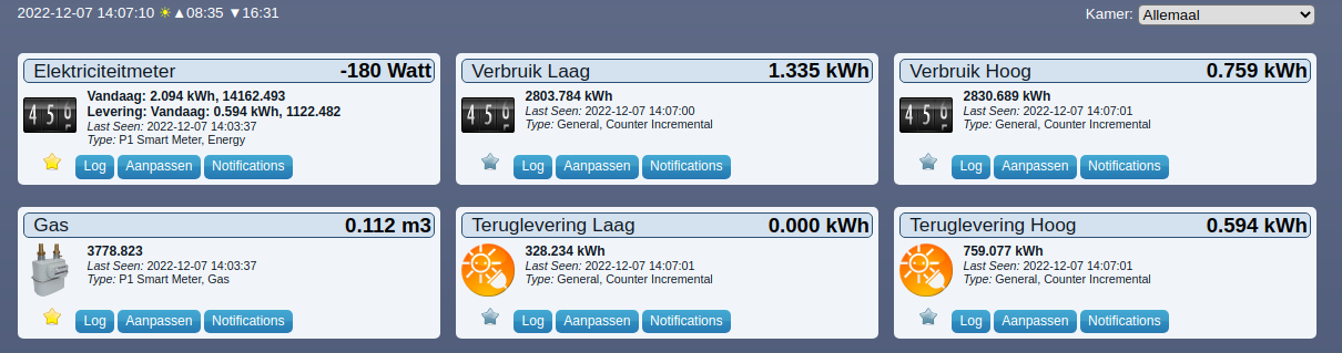

Hello Walter,
Thank you for your quick response.
I'm going to try this out soon.
Your script works perfectly (see foto Teruglevering 947).

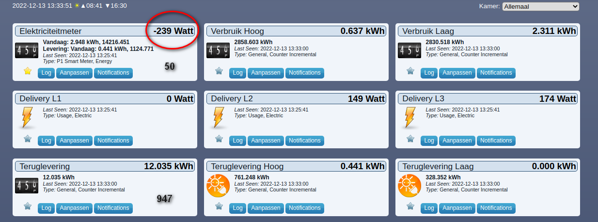

Unfortunately this is not the same value as the negative value in Electricity Meter (50) which I expected
The intention is to use this if P1 (50) indicates a negative value (Photo with negative value -180) . And that is the 6th number of Data.
PS You are aware that delivered by the smart meter is not the same as produced by your solar panels.....
It is produced minus consumed so delivered to the net. Also there is a report function (button) on the P1 meter that shows exactly the P1 deliverd totals per year, month, day....
I'm not aware of this. I am using a script that only has 4 switches. And that works perfectly happily.
Because I have had solar panels for a few months now, I also want to do a little more with them if possible.
I want to use this negative value to switch on an electric heater with switch 947 (foto elektra nieuw).

Hi Walter
This was the situation this afternoon with your script.
See photo and json printout.
I want to use the negative number of Electricity (50).
In switch (947) this number should then be the same.
json

Posts: 6691
Domoticz version: 2025.1
Re: Script for P1 not working good
I do not think it is possible to send negative values to an Energy counter. There is currently a discussion on this on the forum.
The negative value you see on the widget electriciteitsmeter is only a display value.
What do you want to do with this new counter? Because when you click on the Log button and then on the Report button you will see all kind of nice information already prepared for you. See wiki for a screenshot of a report. https://www.domoticz.com/wiki/Dutch_DSM ... th_P1_port

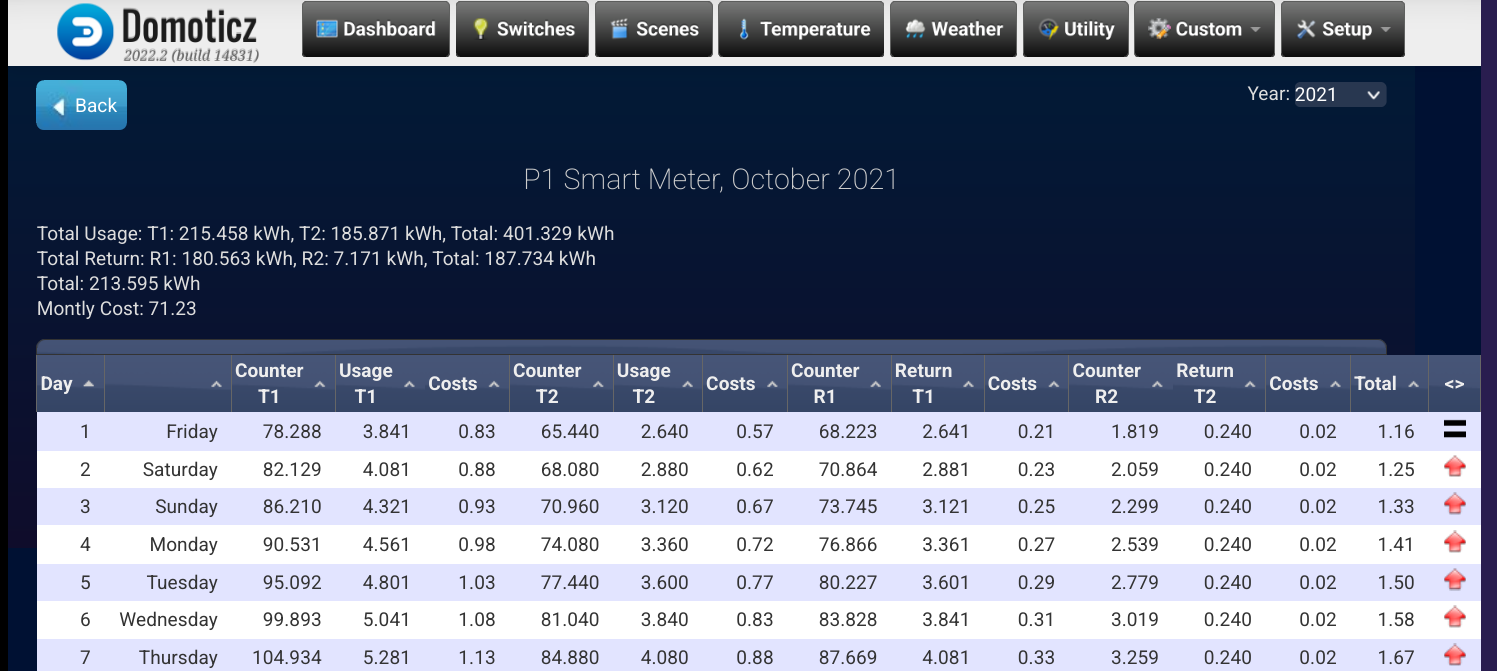

Posts: 6691
See screenshot below for a report of a month in the past.
It is fake information but you can see what is reported.

Posts: 6691
So you have a 3 phase inverter.
In the screenshot I see -239 Watt delivery, Delivery on L1=0,L2=148,L3=179
So on L1 there should be usage of approx 148+179-239=88 Watt. That should be visible on the L1/3 Usage devices.

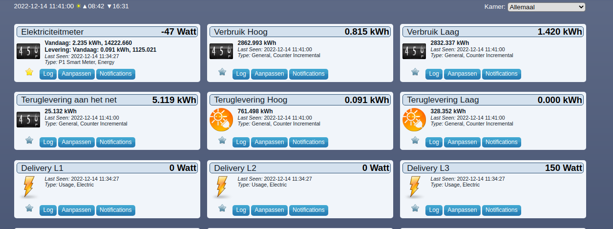

Post by Fredom »
waltervl wrote: Tuesday 13 December 2022 22:30 So you have a 3 phase inverter.
Hi Walter,
If I understood you correctly, then according to this afternoon's photo I would have a return to the net of 103 watts.
What I find very strange is that the electricity meter says -47 watts and that is also reflected in json, but on switch 947 you see a feed-in of 5,119 kWh, there should also be 47 watts.
json

Posts: 6691
If you go to your complete device list in Domoticz, menu setup devices, you should see 2 sets of L1-3 devices, Usage and delivery. The sum of all these 6 devices will give to nett feed back or usage to the net and should be the same as the value in the P1 meter device. The JSON is just a domoticz summary calculation of the smart meter telegram and should not differ from what you see on the device widget.
