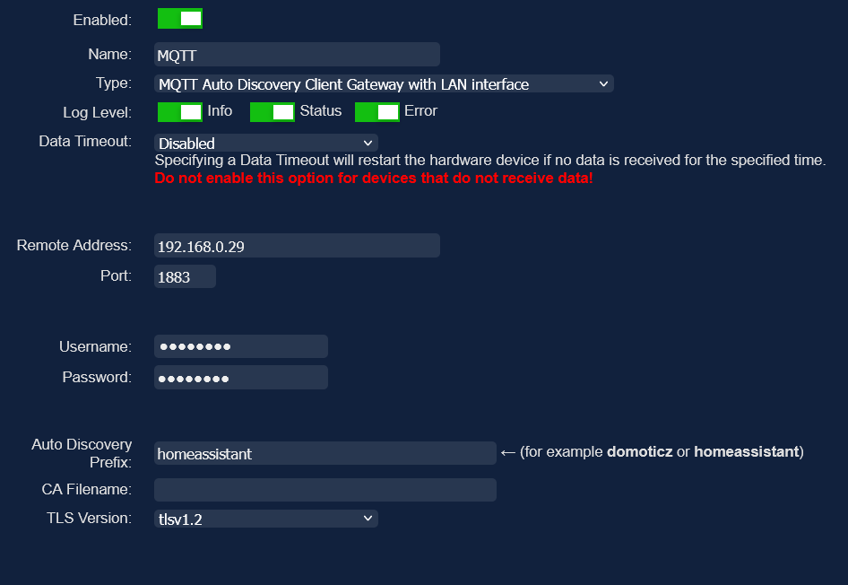

Re: MQTT Audo-discovery
I'm trying to setup a new Domoticz installation on an Rpi 3B with Bullseye 11 to eventually replace my current production installation.
I've installed Docker and Domoticz, MQTT (Mosquitto) and Zigbee2mqtt in their respective containers.
So far I have just one Zigbee device, a Sonoff temperature/humidity sensor (SNZB02) paired to a Sonoff Zigbee 3.0 USB Dongle plus.
Zigbee2mqtt connects correctly to Mosquitto and I can see the device and values in MQTT Explorer.
So far so good, the problem I'm having is in getting Domoticz to create this device via the auto-discovery method. Although the Domoticz appears to discover the sensor no new device is created and there are many error messages in the log about "invalid/unhandled data received"!
As far as I can see I have configured things correctly, but obviously I'm missing something
So any help would be much appreciated.

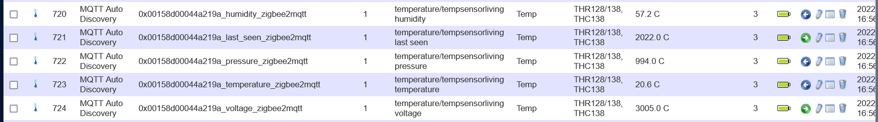

brjhaverkamp
- Posts: 56
- Joined: Wednesday 06 December 2017 16:42
I switched yesterday from the zigbee2mqtt plugin to MQTT autodiscovery.
After some back-and-forth between zigbee2mqtt and domoticz I have it operational.
All my zigbee devices flooded in nicely. A lot more than with the zigbee2mqtt plugin, because all sensor are separate devices. But that is OK.
I now have one weird effect:
My aqara temperature/humidity/air pressure sensor (WSDCGQ11LM) is reporting everything in Celcius. Even the humidity, air pressure and battery voltage. What has gone wrong here? Did I do something wrong? Is this a (known) bug? And is there a way to fix this manually?
Hope you can advice,

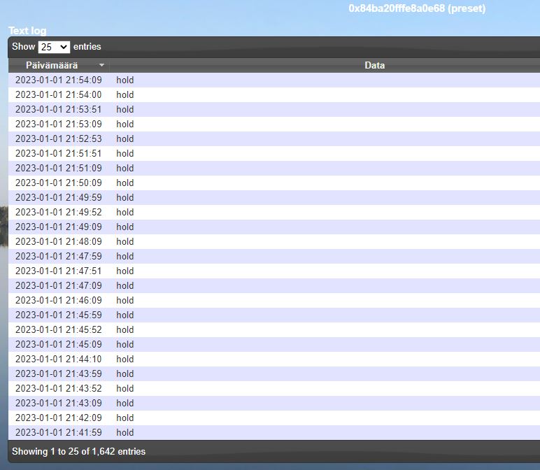

My Moes BHT-002 zigbee thermostat gets autodiscovered, but it is missing heating/idle status from running_state. Also,
In Domoticz I see this in log:
Fearing my short log soon explodes if I install more of these.
edit: I noticed it is only saving the short log for the preset which is understandable as it "changes". What is strange that I am running Zigbee2MQTT plugin on the side and it creates similar devices (+ the running_state), it does not report the preset to be changing like in above screenshot, but it still logs everything: edit2: Except this one stopped about three hours ago, it is currently not logging the same status anymore. This happened when I restarted Domoticz. The other thermostat is was mpt doing this switching which the device created by Zigbee2MQTT plugin.

}edit: I noticed it is only saving the short log for the preset which is understandable as it "changes". What is strange that I am running Zigbee2MQTT plugin on the side and it creates similar devices (+ the running_state), it does not report the preset to be changing like in above screenshot, but it still logs everything: edit2: Except this one stopped about three hours ago, it is currently not logging the same status anymore. This happened when I restarted Domoticz. The other thermostat is was mpt doing this switching which the device created by Zigbee2MQTT plugin.

I am switching to Zigbee2MQTT and Zigbee2MTQQ is running fine
Zigbee2MQTT log:
ESPeasy also does not give errors when using Dototicz MQTT as controller.
Mosquitto also seems to be running:
Domoticz seems to have no issues with MQTT:
In MQTT explorer I see a lot of messaging going on. Especially under $SYS
Yet I cannot see any MQTT devices in Domoticz.
I'm using MQTT Auto Discovery Client Gateway with LAN interface with localhost, port 1883 and homeassistant as autodiscovery prefix.
Does anyone have a clue what I'm doing wrong?
