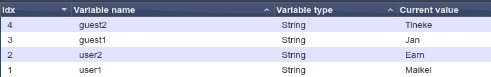

These are my user-variables in domoticz;
Screenshot 2022-12-09 at 09-14-40 Domoticz.png (15.49 KiB) Viewed 1758 times
