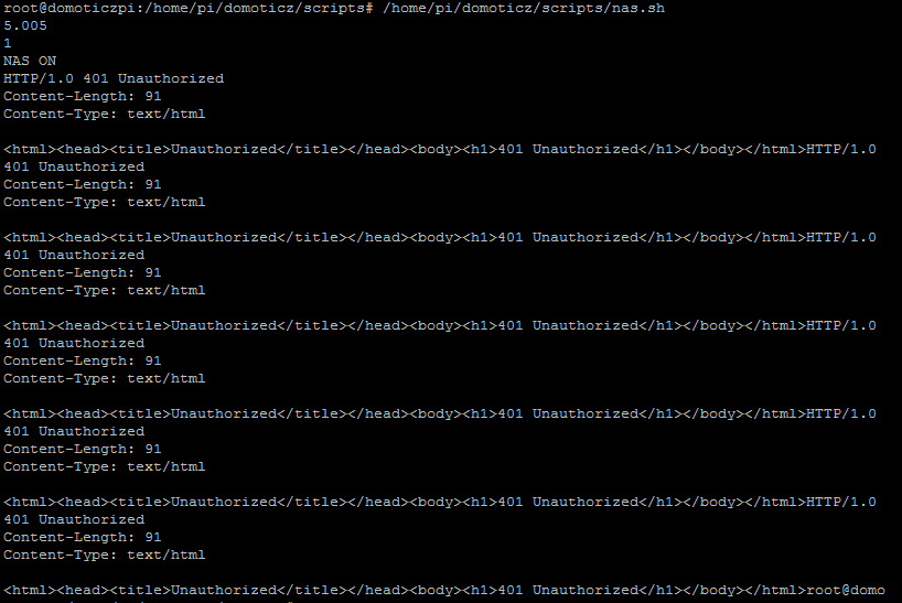

I've managed to get the virtual switches but when i test the script i'll still get this?
roblom
Posts: 408
Joined: Wednesday 26 February 2014 15:28
Location: the Netherlands
Re: HowTo: monitor Synology NAS
Post by roblom »
Did you make the script executable:
sudo chmod +x nas.sh
Is this a windows machine?

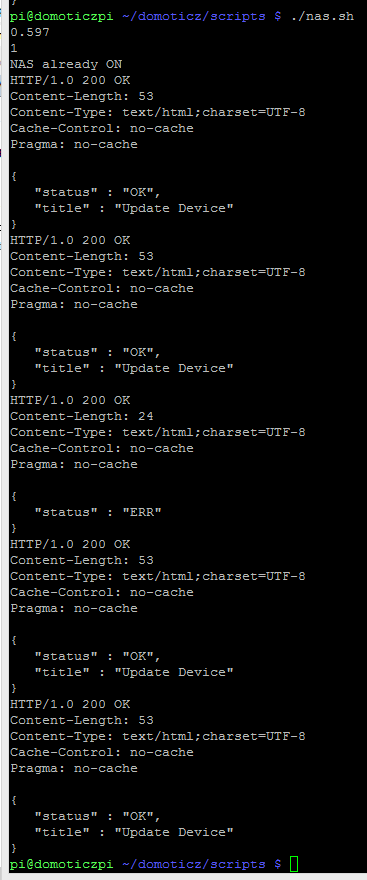

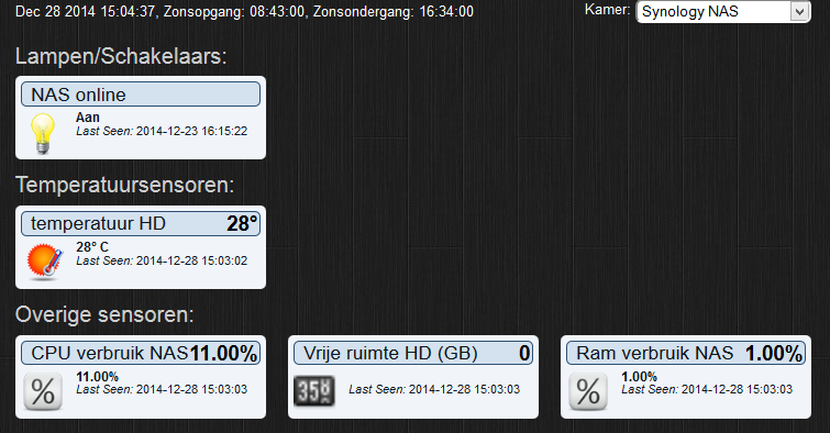

I've managed to get it work. But there are a few things that i don't get to work.
- Memory use is allways 1%?
- Its seems that the crontab is not working, because it doesn't update?
But when I run nas.sh in the terminal its working. ( I've another crontab running what is working)
- On dashboard the free HD space doesn't show the right free space.
running nas.sh
running nas.sh
running sh.PNG (24.79 KiB) Viewed 8269 times

I was having the same issue as Swordfish, because is have a username and password installed.
i've edit the script (for synology) to:
 #!/bin/bash
 # Settings

In the script something is wrong. To calculate the free memory percent, the MemAvailable will be divided by 1024. For a synology with 1024MB RAM, this is right. But not for a synology with 512MB RAM. Maybe the script can be updated!
The old script contains:
   # Free Memory Available in %
   MemAvailable=`snmpget -v 2c -c $PASSWORD -O qv $NASIP 1.3.6.1.4.1.2021.4.6.0`
   MemAvailableinMo=$(($MemAvailable / 1024))
   MemUsepercent=$((($MemAvailableinMo * 100) / 1024))
   # Send data
   curl -s -i -H "Accept: application/json" "http://$DOMO_USER:$DOMO_PASS@$DOMO_IP:$DOMO_PORT/json.htm?type=command&param=udevice&idx=$NAS_MEM_IDX&nvalue=0&svalue=$MemUsepercent"
Maybe this can be the solution:
	MemTotal=`snmpget -v 2c -c $PASSWORD -O qv $NASIP 1.3.6.1.4.1.2021.4.5.0`
	MemUsepercent=$((($MemAvailable * 100) / MemTotal))
	# Send data
	curl -s -i -H "Accept: application/json" "http://$DOMO_IP:$DOMO_PORT/json.htm?type=command&param=udevice&idx=$NAS_MEM_IDX&nvalue=0&svalue=$MemUsepercent"
When I look in my DSM of my Synology the percent will be 48%. The script shows 3%. I don't know why both values are different. Hopefully somebody can explain this?

i Jan,
Is right, we have a problem with this formul.
On my Synology i have that :
On Domoticz :
I don't understand how synology obtain 33% memory use...is egal to 337,92 Mo. :roll:
On my screen memory free (libre) = 106 Mb (10,5%) !
You have a same problem ?
