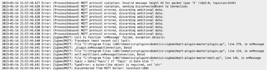

I have the same issue after upgrade from Domoticz 2022_1 to 2022_2 on Windows 10.
Domoticz keeps restarting after each 5-10 sec.
MQTT and Zigbee2MQTT are still working, so I can monitor and control the connected devices from the Zigbee2MQTT portal/dashboard.
Disabling the Zigbee2MQTT Hardware in Domoticz, stops the restarting, all other non Zigbee2MQTT devices work properly.
Enabling the Zigbee2MQTT Hardware in Domoticz, brings the restarting back. So for now I disable it, but obvious I will miss a number of devices.
Any idea how to solve this issue?
Regards, Jack

For others that run into the same issue:
I solved it on my installation by changing in Domoticz Setup the Zigbee2MQTT hardware type from "Zigbee2MQTT" (Domoticz Zigbee2MQTT Python plugin) to "MQTT Auto Discover Client Gateway with LAN interface" (build-in feature).
I had to remove the old devices and to enable the newly create devices in Domoticz Setup.
Device names remain the same, but new devices get new device ids.
Regards, Jack.
